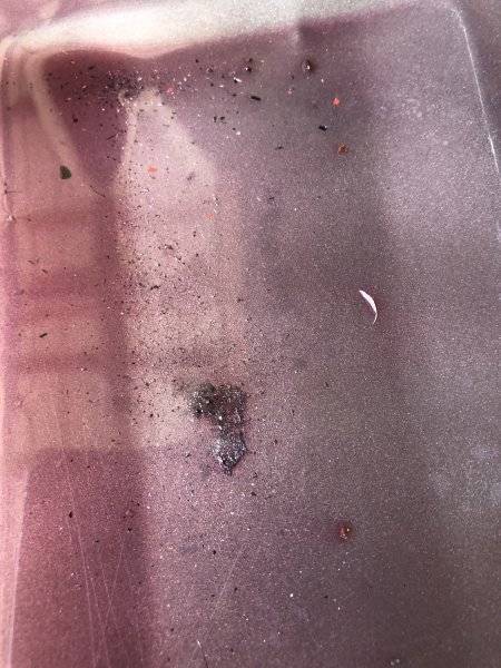

Well, I got everything diconnected and ready to drop. Last thing was to drain it. Accomplished that and took off the pan...have me a little "look see". Lots of chips. Big ones, small ones, finely powdered stuff too. I grounded aircraft for much less debris than my poor transmission had in it.
Thanks for all the advice gang. I checked everything mentioned multiple times just to make sure I could check that box.
I have learned a lot from all the advice, ideas, and personal observations. Honestly, while hoping I would be wrong...I just had a feeling that this would be the outcome.

Yup, Dave and I have been talking and texting for the past 2 days ! I left the debris in the pan in case he wants to frame it !

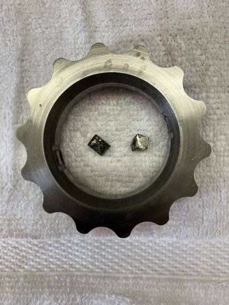

I've done that once myself, converter slipped out a little when mating to the engine. Then tightening down the bellhousing bolts broke the pump ears. It screeched for a few seconds after engine start. Now I'm a lot more careful.
