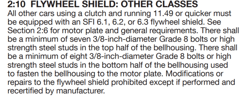

From the 2024 NHRA rule book
Doug
Doug
So you need a minimum of 15, 3/8" bolts holding the bell housing on? On a BB Mopar you fail before you start, there are only 6 bolts on bell housing and 2 are below the crankshaft therefore bottom half. Typical NHRA jibberish. Worse than dealing with the government.

Thats only below 11.49. When required those extra bolts do not go into the block. They go into a mid plate between the block and bell housing.
