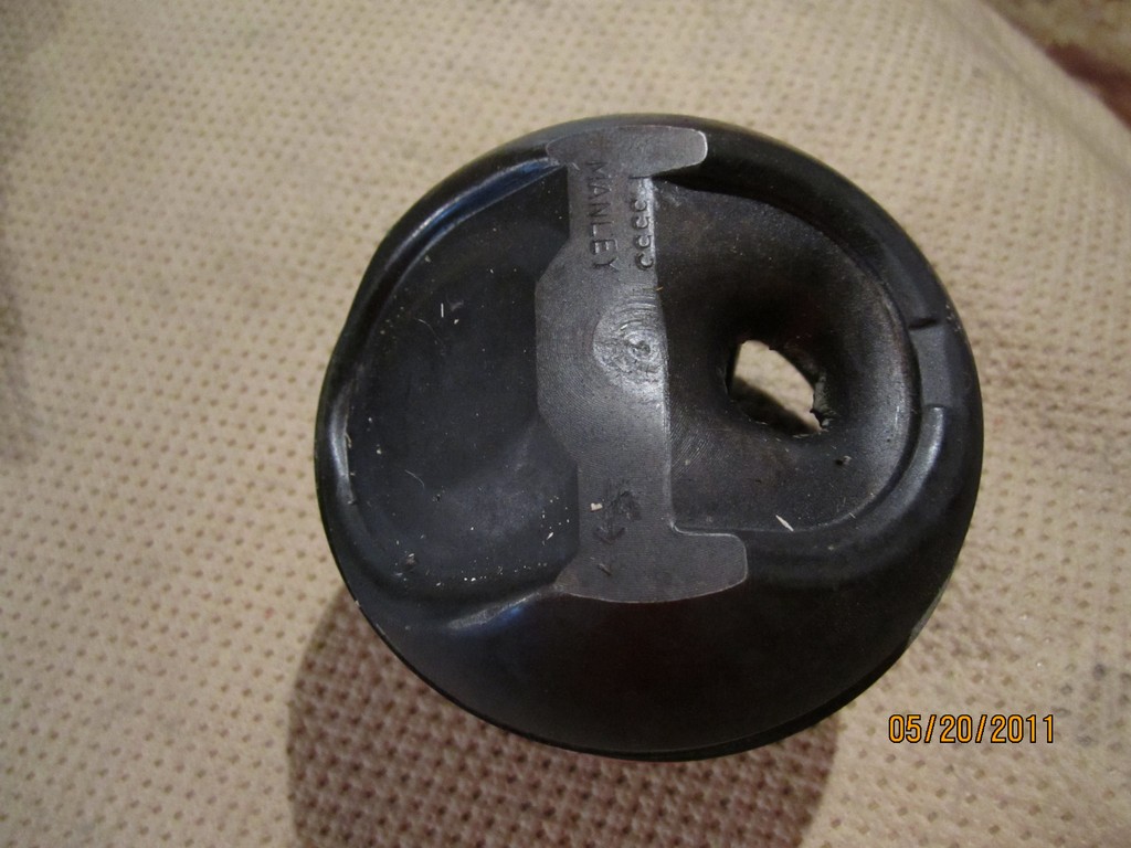

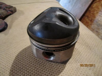

If your piston looks like this,don't spray it:icon_compress:

Ouch lol. Who tuned and installed the nitrous system?
The piston failure was due to cylinder pressure being greater than the piston could handle.When I find the other piston and take a pic,you'll see a dent like it was hit with a ballpeen hammer in the same spot that this piston blew through:blob1:
