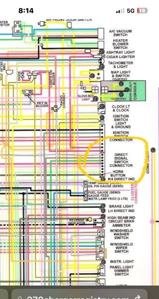

Went to take the car for a ride this evening and had no brake lights. Brought it back home and fiddled with it for a few minutes. Narrowed it to down to the Direct signal switch connector before I had to quit. It had power going to it coming from the brake light switch but none coming back out of the brown or green wires. I did unplug/ inspect, plug back up. Still didn’t work and then I got the final yell that I had to leave lol. I’m just wondering what’s going on right here at this plug in? Guess I’ll dig in to it tomorrow.

It’s a digi tail set up but I also took the kick panel off and unplugged the tail light harness and tested there also. No brake lights coming out the main harness to that point either. Has to be the turn signal switch don’t it?
Sounds like it. I replaced the Chinese turn signal switch, that was in the car when I bought it, with a NOS I found on eBay. NOS wasn’t cheap, so I hope it lasts longer. If not, the Chinese stuff is 1/3 the price, I could get 3 of those for the price of NOS. Only bitch about that is having to pull the steering wheel every time they need replaced.
