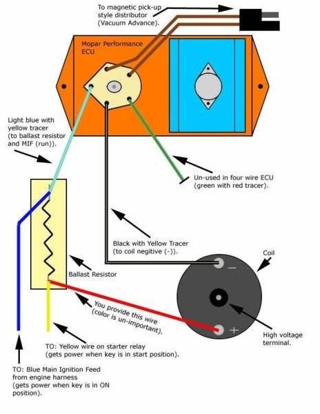

Start with looking at this diagram to ensure you are only looking for 12 volts where it should be, and when it should be, meaning whether key ON or key cranking. I would not necessarily pay attention to the wire colors on this diagram tho. Don't just throw parts at it by any means, but if you are stumped and you have a spare box or coil, that may help you along. HTH, Lefty71

becarefull with that diagram. The yellow wire arriving to ballast and coming from Starter relay is a lates 70s thing. Up to 74 at least comes from ign switch in a brown wire
