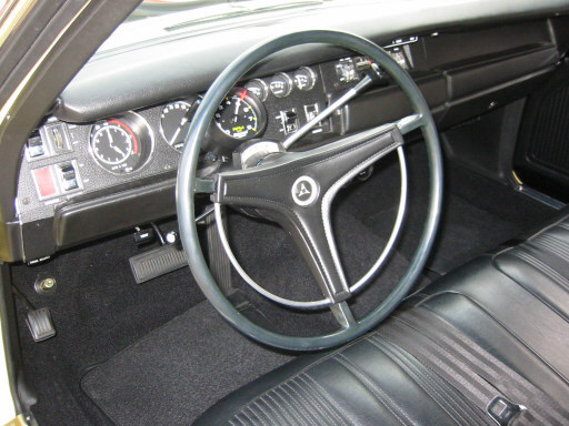

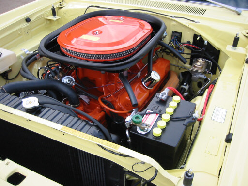

this is the car I am working on. It's perfect in every way except this problem. A real M code A12 Superbee.
