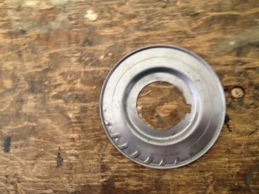

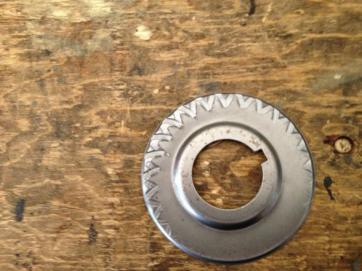

An even darker shot is, the oil slinger was installed backwards and is being ground up by the timing chain. :sad2:
Just saw an example of this on the forum here recently.
Could also be that 1 bolt in the cam is loose.
Look forward to hearing the result of your exploration
Hopefully this is not what you have going on as mine was installed correctly and still did the same thing of grinding it. This also was done on a 65 383 motor with a double roller timing chain. New replacement motor is going back in the project this week...
