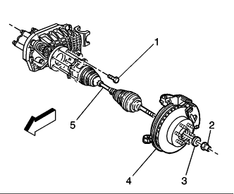

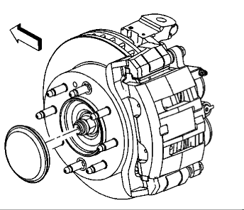

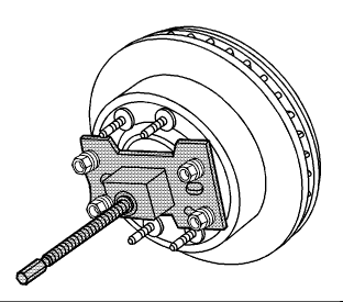

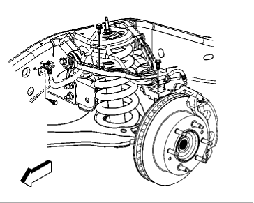

  1. Remove the tire and wheel.
  2. Remove the rotor.
  3. Remove the wheel speed sensor and brake hose mounting bracket bolt from the steering knuckle.
  4. Remove the wheel drive shaft nut retaining cover.
  5. Remove the wheel driveshaft assembly retaining nut (2) and washer (3) from the wheel driveshaft. Do nut reuse the nut. A new nut must be used when installing the wheel drive shaft.
  6. Disengage the wheel drive shaft from the wheel hub and bearing using J 45859 or equivalent.
  7. Remove the wheel hub and the 15-series bearing mounting bolts (4).

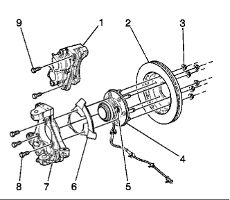

9. Remove the wheel hub and bearing (4) mounting bolts, 25/35 series.
10. Remove the wheel hub and bearing and splash shield from the vehicle.
11. Remove the O-ring seal from the steering knuckle bore, 25/35 series.
12. Remove the wheel speed sensor mounting bolt (5).
13. Clean and inspect the O-ring seal, 25/35 series.
14. Replace the seal if the following conditions exist:
Nicks
Cuts
Dry or brittle
Compression set
Reassembly is exact reversal. Note where it says 25/35 series does NOT apply to the 1500 series. Hope this helps.
air hammer or drift and hammer should work fine to remove the axle from the hub if it sticks.depends on the amount of rust in there.you dont normally need the puller unless it sticks really bad.
