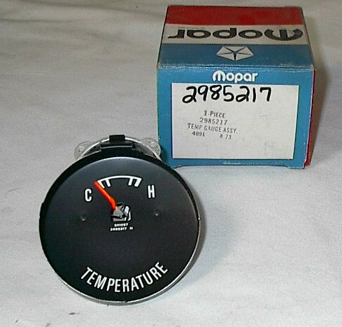

what is the normal operating temp range for a 383 b body ? after driving for 2 hours at roughly 50-60 mph my temp gauge was reading to the last line before hot ( it didn't overheat) is this ok ? ambient temp was 30-35 C( 86F-95F)

As for the temp...yes..you were on the warm side..close to hot...I ran the factory gauge and an aftermarket gauge and when the factory got that high it was a tad over 200 on the aftermarket...maxed out factory read about 210 on the aftermarket and 210 is too hot to run old iron regardless of what a few on this site have submitted....My 2010 chevy truck runs at 210 all day....the cooling/motor were designed that way...old iron likes 185 to 190..my 2 cents of over 50 years driving mopars

no idea what thermostat is in it or if the gauge is correct its just "as it came " from the states . was its first trip since getting it rego'd . 2 freeze plugs were "weaping" and needed replacing before they would pass it for rego
have driven it around town for hours with the gauge not getting above 1/2 way , it was only after a long highway run that it started getting hot , still didn't puck out water or overheat
