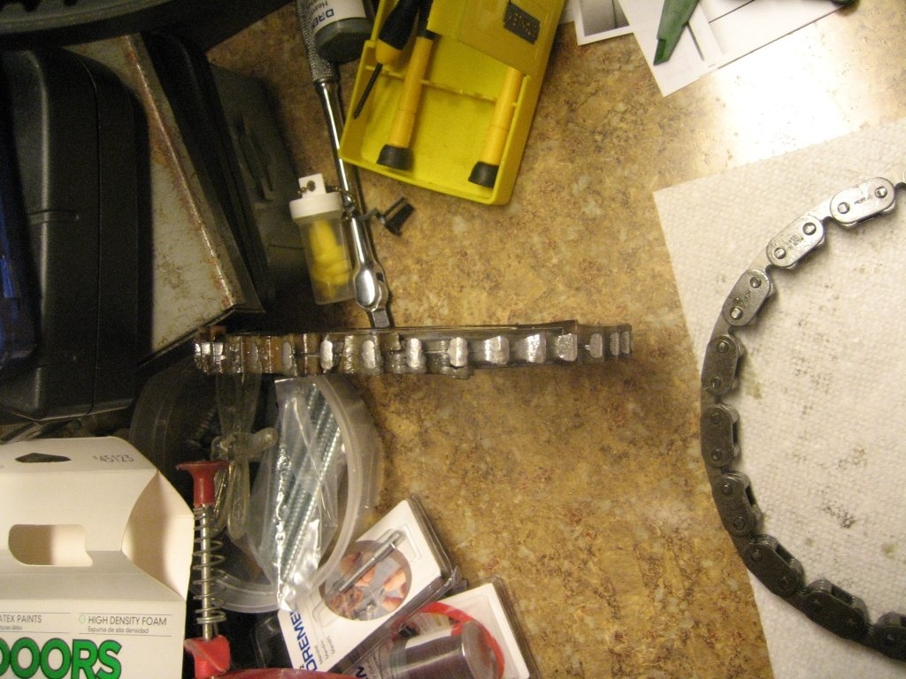

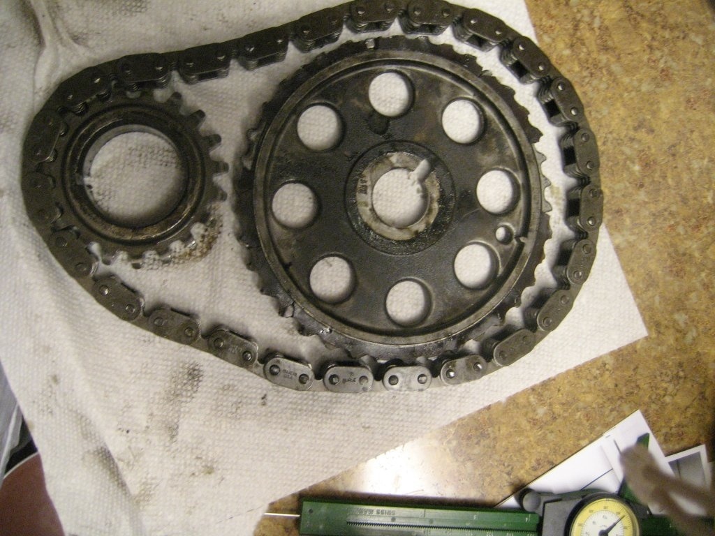

Well, took my 74 Runner 400 to fill her up with gas yesterday and got about 2 miles from my house when all of a sudden loss of power, a couple sputters and dead. Pulled over and did the Mopar ritual of changing the Ballast resister to a known good one, next the coil, and last the Ignition box still no fire? Lastly took off the distributor cap, gave her a crank and no spin of the rotor. The distributor is still connected the the distributor drive gear. (Tried to turn rotor by hand, just the normal amount of play, does not turn freely) So assuming the nylon teeth on the sprocket gave up the ghost?) So now I am trying to decide if I should attempt this myself? The service manual says you need Tool C-3688 and C-3509. So wondering if these specialized tools are available for rent at Autozone or somewhere?

Well I am sure to many of you have seen this before? Looks like I'll have to drop the pan.

I'm a small-block A-body guy, but with the amount of metal gone from the timing gear I'd want to go through the entire engine. Not just drop the pan.
You won't be able to turn the cam gear very easily because it has valve spring tension. It will turn it just won't spin freely. The only reason to drop the pan would be to get the nylon pieces out and check the pick up tube for chunks of nylon also. JMO
