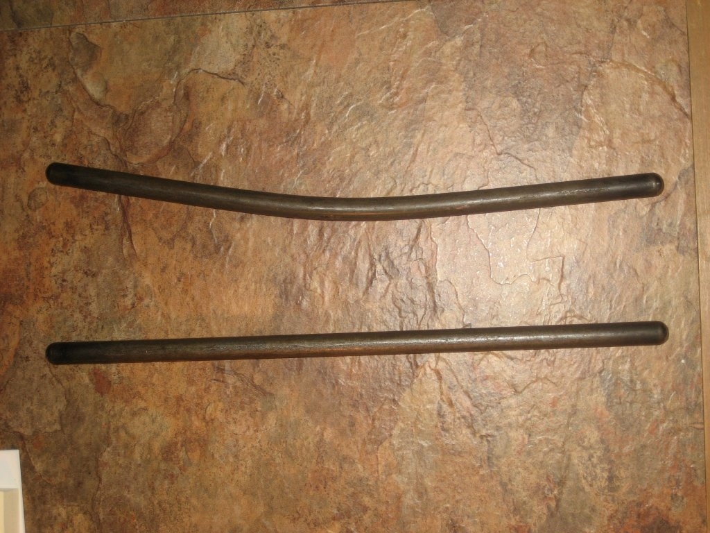

Well well, looky what i found here on #7 exhaust....

Silly question: Do I replace all or just the one bent one?
For your stock application older motor I would just replace the bent ones.
Ok Condor74
Thanks for your input. I only found the one bent pushrod. All others appeared to be straight.
Is there any harm in just replacing them all since the cover is off of best to leave the good ones alone?
Well replaced the bent rod, still not running to well so I guess it's time to pull the heads. Would like to know your thoughts and what others have done in similar situations? Originally wanted to keep it stock but now If I have to pull the heads anyway maybe spice it up a bit. Just would look to add a few horses without breaking the bank. Or maybe just pull the engine and have it gone through. Any good Mopar guys in central MA?
I don't know the history or the mileage on the motor but I would probably pull the heads and figure out which valves are bent and repair as necessary. Might be good to have a full valve job at this point.
If you think the motor is very high mileage and or tired or worn a full rebuild may be your best bet.
As far as similar situations. I have been in the exact same boat. I replaced the valves . The main difference was I worked in a shop that had valve grinding and seat grinding equipment. I replaced the bent valves myself.
