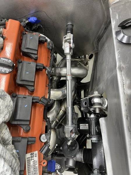

More progress. Made the pipes come together for a x pipe and added v-bands for the collectors. Still need to move the o2 sensors and add the cats.
Sure makes doing the exhaust easier when you can get at it from multiple angles.

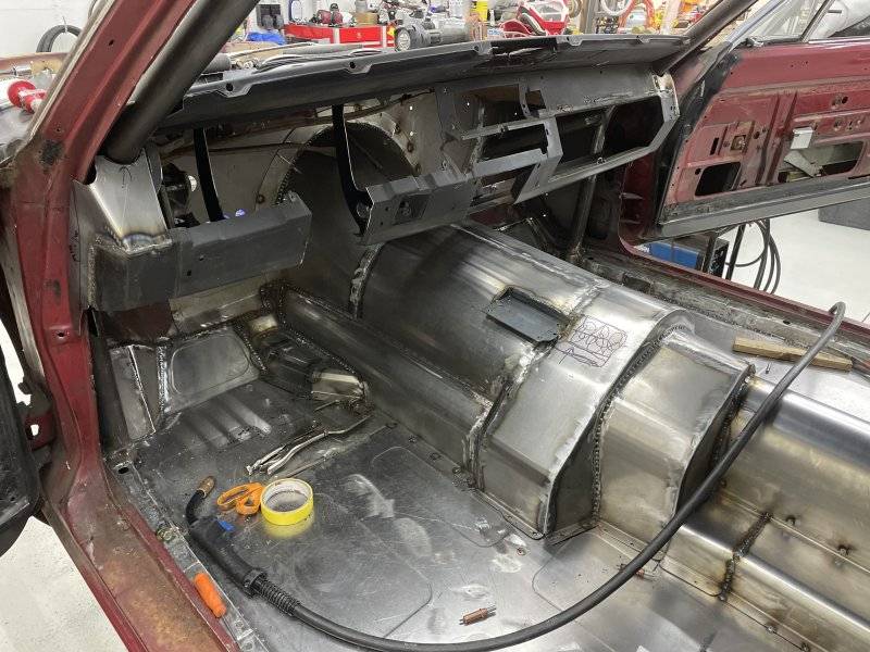

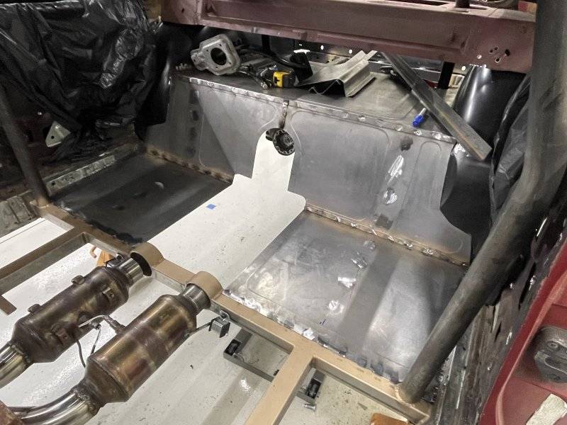

Some weekend progress. Now time for the harder tunnel work that I am not looking forward to.
Tunnel is done but not fully welded in. Waiting until all the fab is done and will pull the trans out through the inside while I can. Way easier. Working on the A/C now. Was trying to use the Jeep unit but way too big. Has this vintage air left over from another build and it is going to work. Column is in and the dash is moved back 2” to house all these items. Have just the wiper motor and dash cross bar to install.

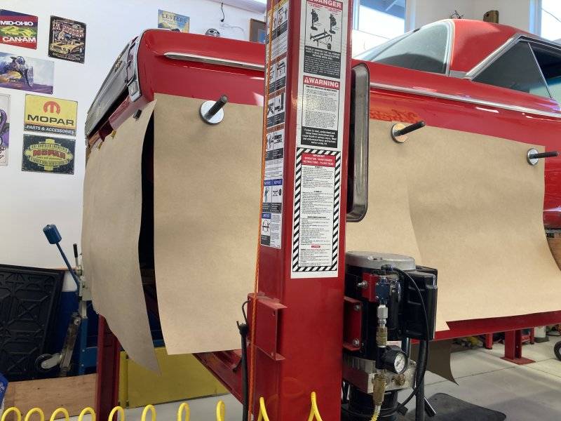

Smokin! If you are in need of large pieces of poster board type material for making patterns/templates, I've been getting them from Costco. They can be found separating the layers of TP or PT on the racks. A friend of mine works there so he got me several on a previous trip They are like 3'x4' sheets. CC just tosses them in the recycle.
I also used them for grit shields when I was working under the car as you can see. Helped keep it from getting flung all over.

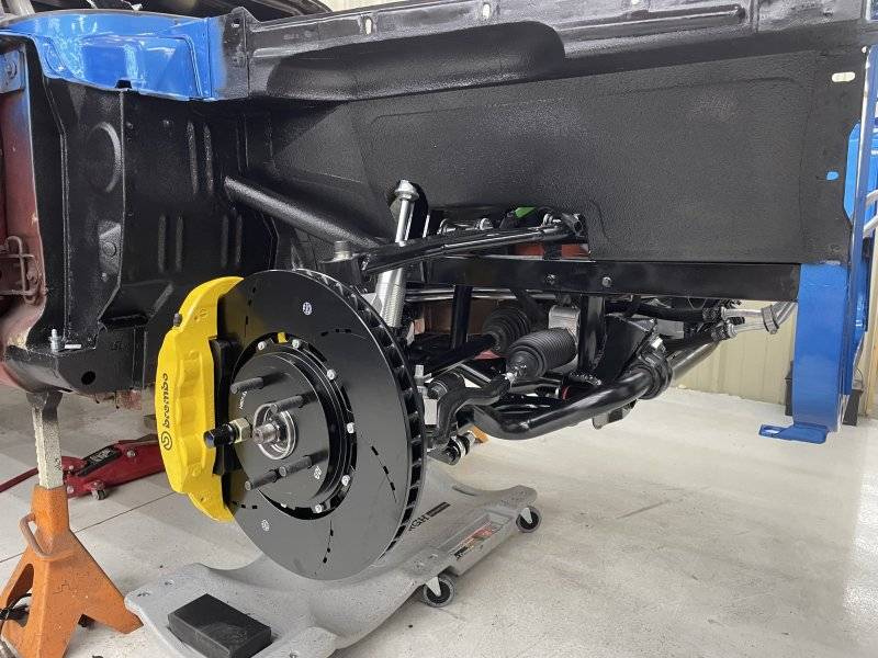

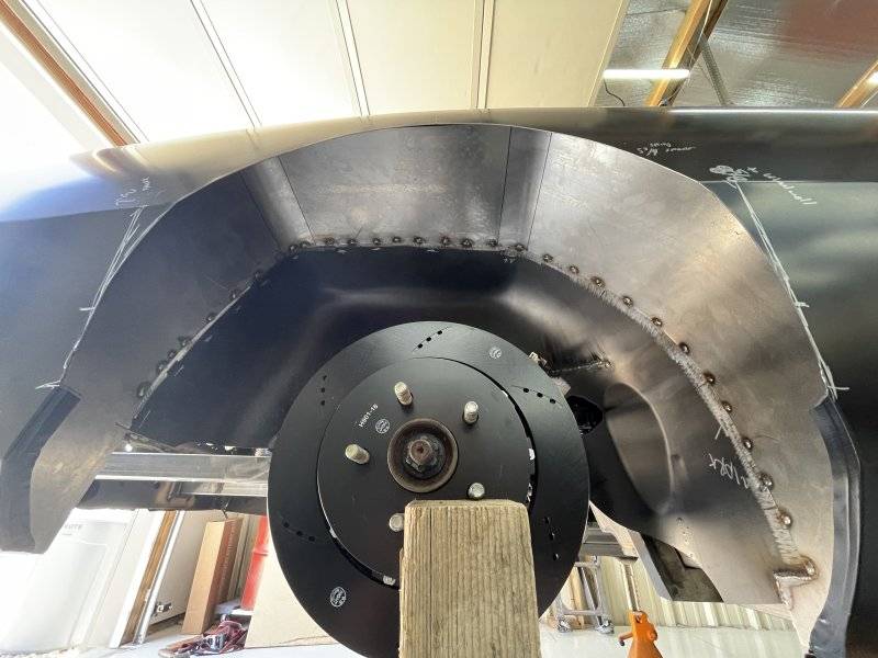

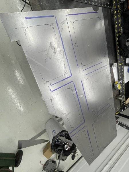

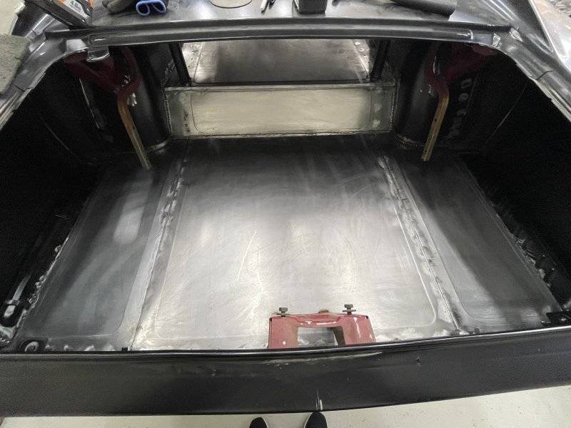

With good weather lately the car has been not as much of a priority but some progress. All the floor is done inside and just finished the wheel tubs and trunk floor. Hood hinges are next as there is less room now from modifying the inner fenders for tire clearance.

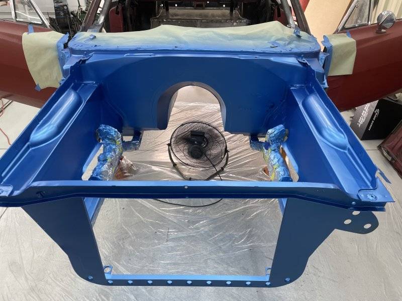

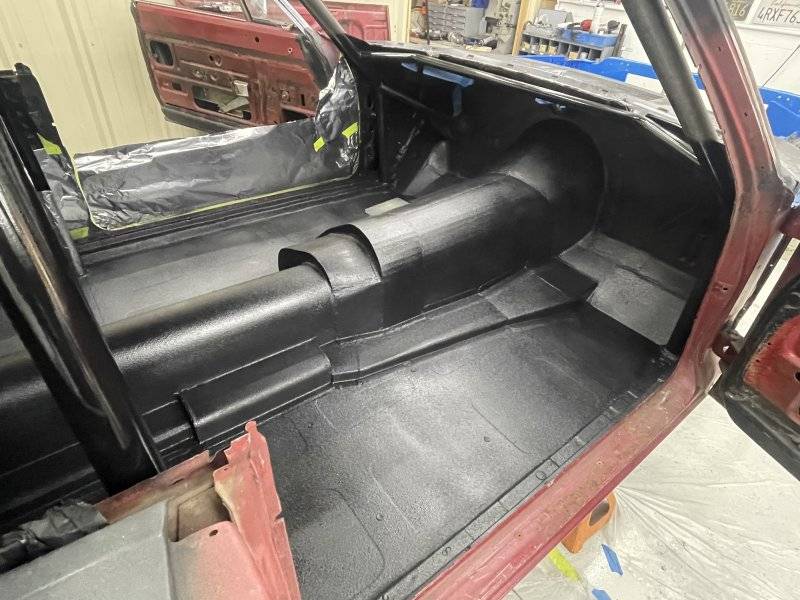

Been busy with work and home but made some progress. Inside and underside is bed lined, engine compartment painted and engine is in.
