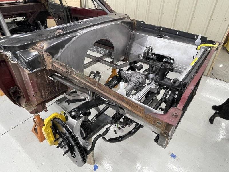

Getting the front inner fenders done. Sent off the cross member for powder coat.
How vertical is that steering shaft coming out of the rack?

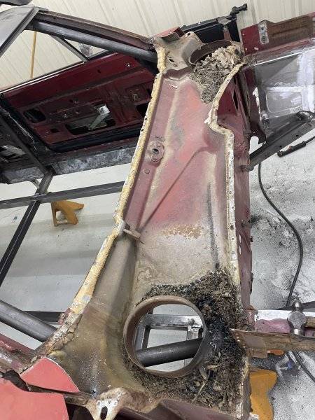

Inner fender wells done. Got the cowl off and found some presents. Overall not too bad in there.
How are you separating the spot welds, drilling them out/spot weld cutter? Do you plan to use cleco pins to put the cowl panel back on? Never removed a large panel, just curious encase I have too at some time.
I did/do use a spot weld cutter. As for the fitment, I use different types of vise grips if the panel has a flange. I have used a spot welder or punch holes in a panel then plug weld it in place. For the cowl I will do the spot weld as I can get around all of the pinch weld areas.

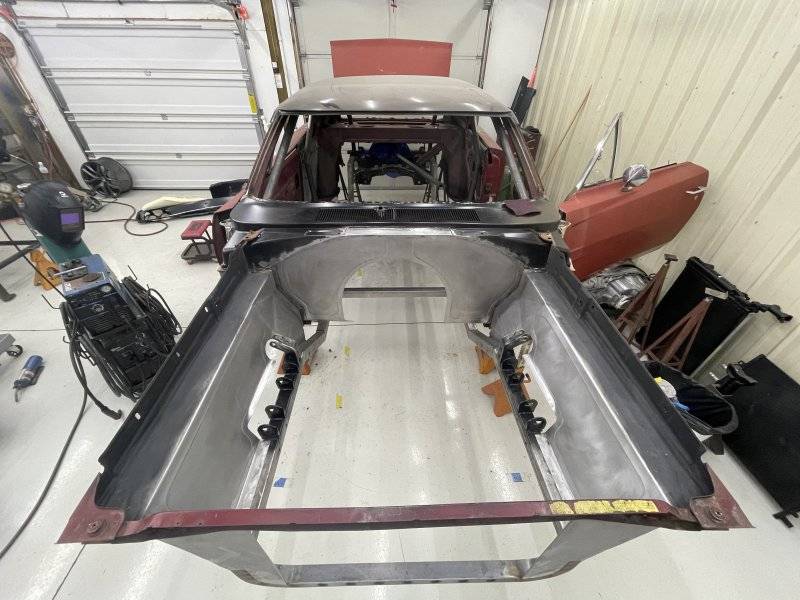

Got to work on the rear for mock up but inner fender wells were in the way so they had to go.

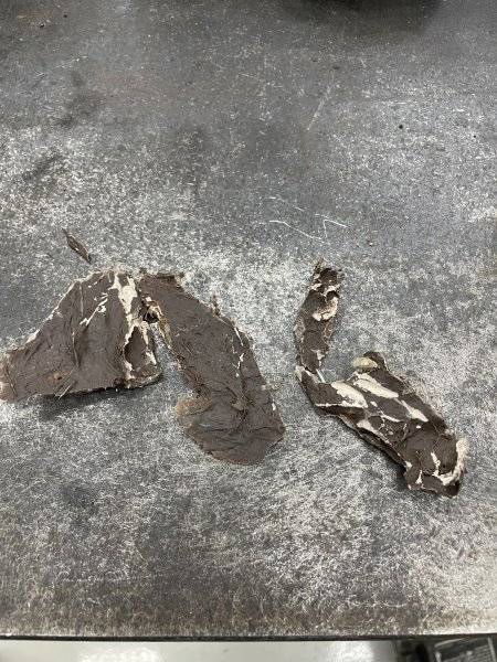

Some things you find on such a overhaul do and don’t surprise you. The 1/4 patch not so much, but the fiberglass and bondo from the inside to patch the lower window rust is new to me.
