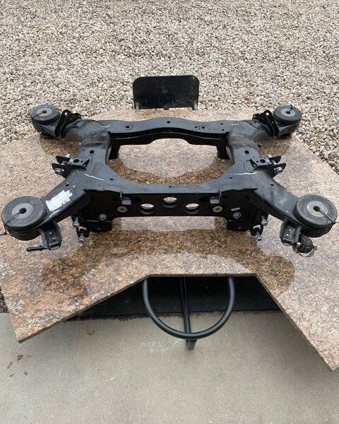

Got the rear crossmember cut down and fitted in the new frame rear section. Next will be drilling all the spotwelds out of the rear floor that was cut out and then fit the frame into its spot.

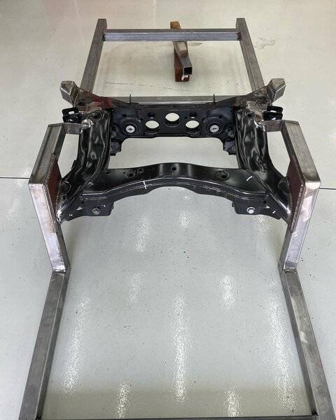

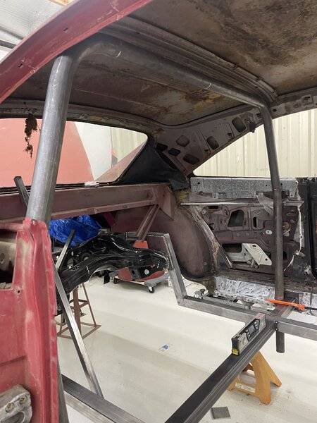

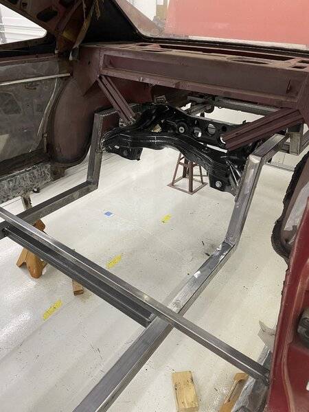

Got the rear section of frame in. Have not tied in to the rear crossmember as all the sheet metal is on indefinite back order. Front frame rails are tacked in. Working on the front crossmember at this time.

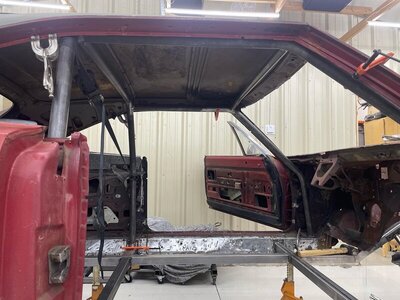

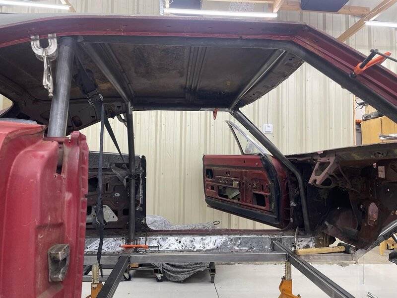

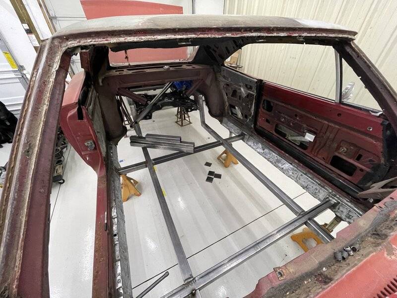

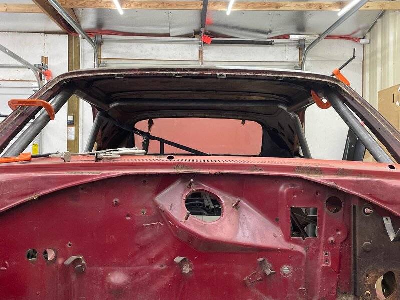

Got the crossmember in and ready for finish welding/gusseting. Started on the roll cage as it will help keep the car rigid.

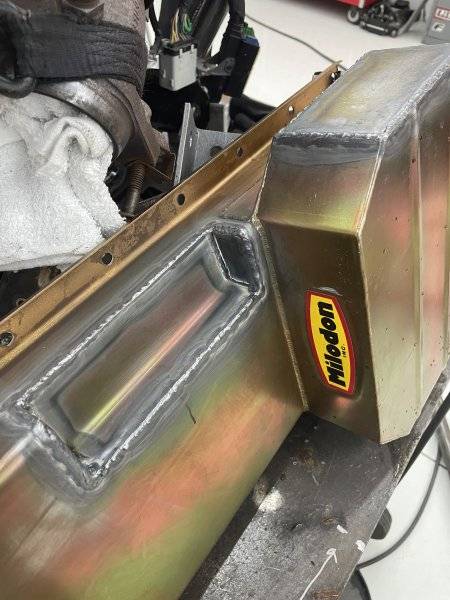

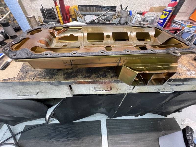

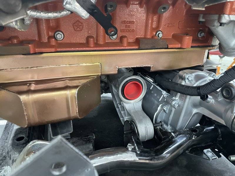

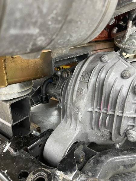

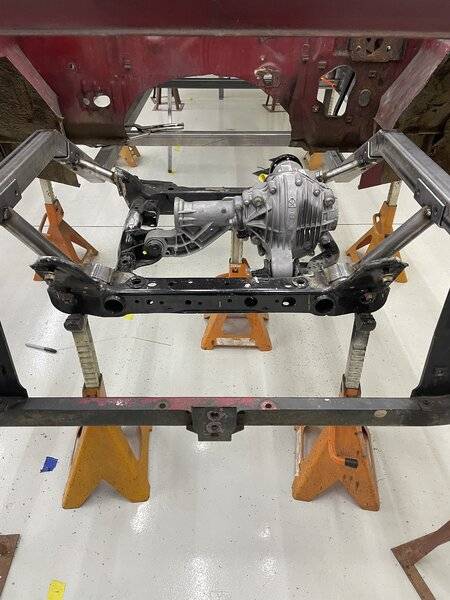

Made progress on the oil pan mods. Wanted to go lower but oil pickup tube and windage tray clearance started getting tight. Next up is motor mounts.
That makes me think of a SEMA trip from a few years ago. In either Weddle or Albins booth, they had sequential 6 speed trans mated up to a 2nd gen Hemi with a dry sump pan and the front diff. The oil pan and diff unit were a one off unit plus the trans. The pan/diff were $100k. Sure was neat looking.

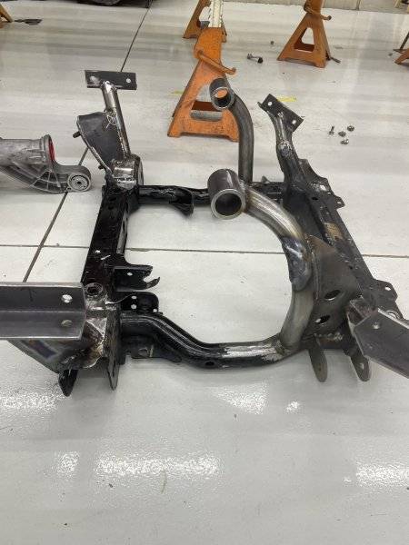

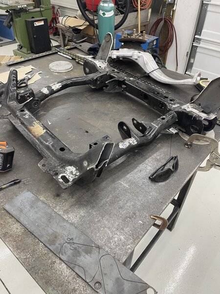

Got the front crossmember done. Motor mounts done. Now the front suspension fabrication starts.
