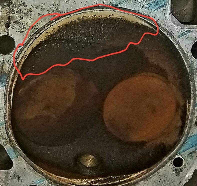

Well **** me got the driver sides off and the gasket doesn't have any exact sign of tear or break But look at this first cylinder!
something got in there and did some damage there are no holes in the piston top and the edges look ok I think something got in there and bounced around pretty good before getting exhausted, wonder if it caused some enough damage to the gasket edge to get a leak?

Is the flat area of the head damaged too? Hard to tell from the pics. Shouldn't hurt the gasket. I think pinging/detonation can cause damage similar to that.
Head has very little damage to the flat area in the chamber othing else, whatever the hell it was slammed around pretty good after it was exploded.
Here is a zoomed in picture. Top circled is the worst there is some opposite corner at the bottom.

I find it hard to believe that there were enough pieces in that chamber alone to cause as many damage spots as shown while none of this debris crossed into another cylinder. This fact along with the amount oil in the chambers smells of detonation. I'd be looking at the ring lands on that piston first. Second the oil source needs to be corrected. Whether rings, cylinder wall finish, or intake leak. This motor is not healthy.
The motor is fine, it's these cheap *** 440source heads and a previous overheat and I found which washer is missing that may be the culprit.

I think I found which washer fell into the plenum and into that cylinder, I seem to be missing one on one of my ARP stainless steel manifold bolts. the only bolt out of all the bolts this one is missing I just never noticed it.
Here is the piston now. Taking the advice of my head builder I clean up the piston and it is good to go now.

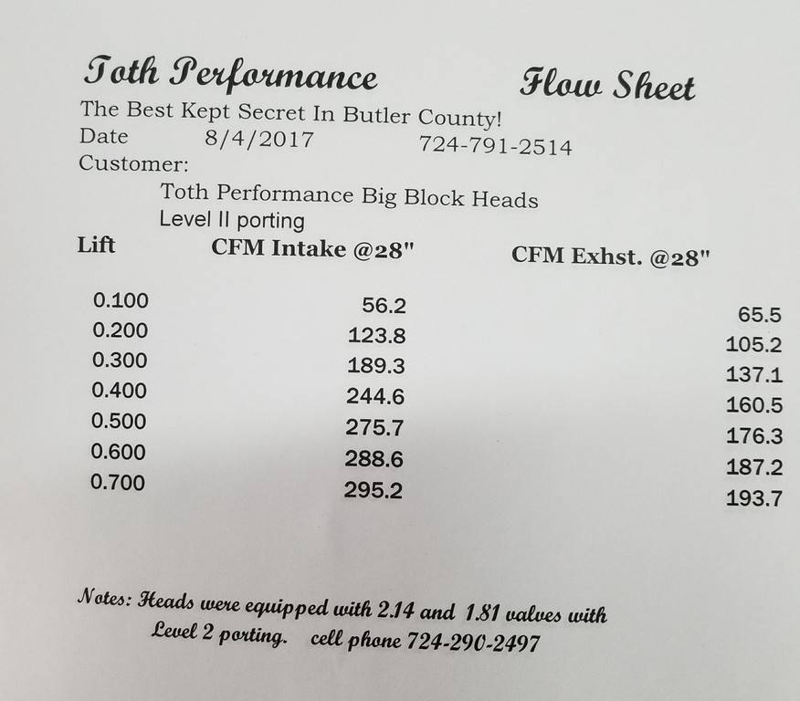

Toth heads on just need to wrap it up. Liking the porting on these and the valves and seals look good. Push rod clearance already done for me. Very happy with these.
Compared to Stealth untouched heads -
