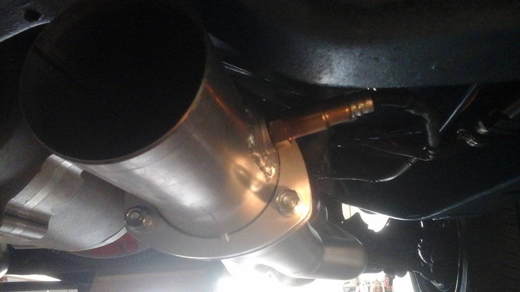

I put mine in the reducer just a head of the trans cross member and behind the header collecter. This is the passenger side. Putting it behind the cross member was further back then desirable by FiTech.
That’s what I’m Using, fitech 1200. Where do they recommend installing. My fitech is sitting at my builders shop still I have to go pick it up

Fitech recommends O2 sensor to be mounted at least 10* up from horizontal, just to stop condensation from settling in the unit and causing premature failure. They said it will work fine... just die prematurely. Plenty of room on drivers or passenger side exhaust so long as it's pointing away from the trans.
I decided to put my o2 in the header collector, maybe an inch from the collector flange, mostly because 1) I plan to replace my exhaust soon and 2) if I ever run open headers... they said it will work fine in the collector.
