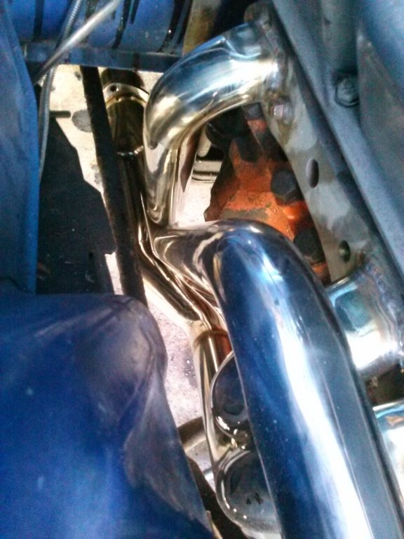

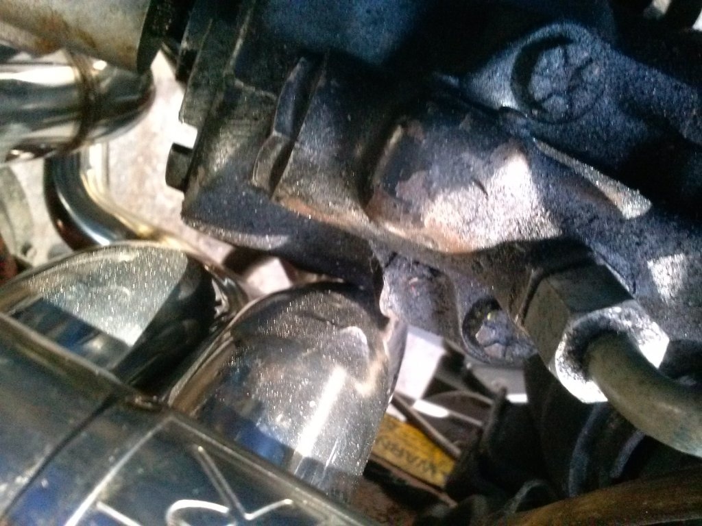

The add said they were for 67-70 B Body. For $320. total including shipping, It was worth trying on my 71.
The passenger side fit fine, no clearance problems around the torsion bar.
On the drivers side, the 2nd pipe from the front is right up against the steering box. I'll have to put some heat to couple areas of that pipe and move it in a bit, otherwise the fit is good. Fit is a lot better then the Hookers they are replacing.
