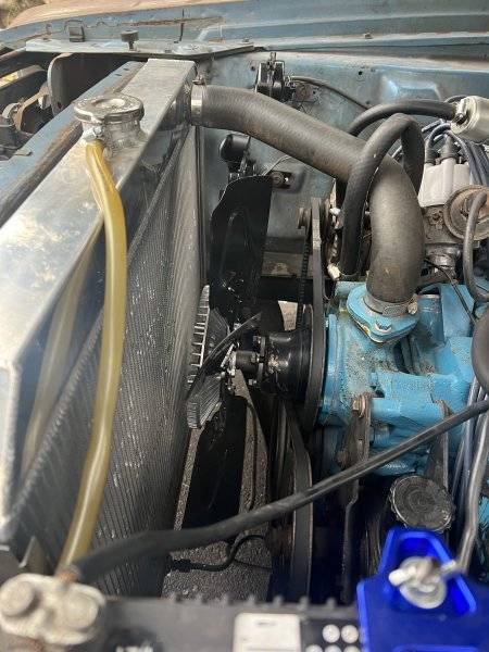

@70beep82 whats with the RED X? You have to run the car to see if the fan is doing its job.

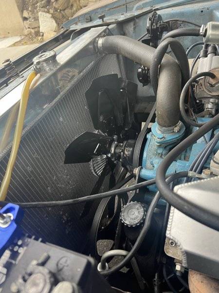

post a picI got ahold of a clutch fan and it works great!

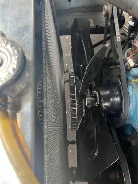

Looks like a HAYDEN unit (because of the slotted mounting bolt holes) ...they are an inexpensive alternative to the Mopar thermal drive clutch (my preference)....but as long as you are successful with your cooing problems...that's all that matters.....GET YOURSELF A SHROUD...IT WILL HELP FURTHER...especially at low speeds....I need to get a shroud still but here
Yes hayden unit for the clutch but the fan blades itself is original! Yes its so much better and working on tbr shroud!Looks like a HAYDEN unit (because of the slotted mounting bolt holes) ...they are an inexpensive alternative to the Mopar thermal drive clutch (my preference)....but as long as you are successful with your cooing problems...that's all that matters.....GET YOURSELF A SHROUD...IT WILL HELP FURTHER...especially at low speeds....
