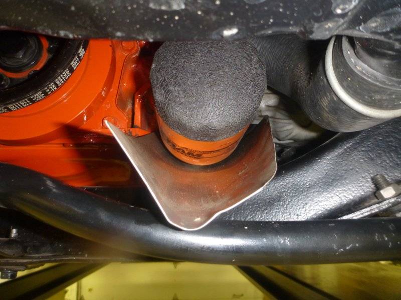

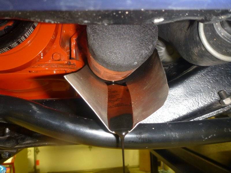

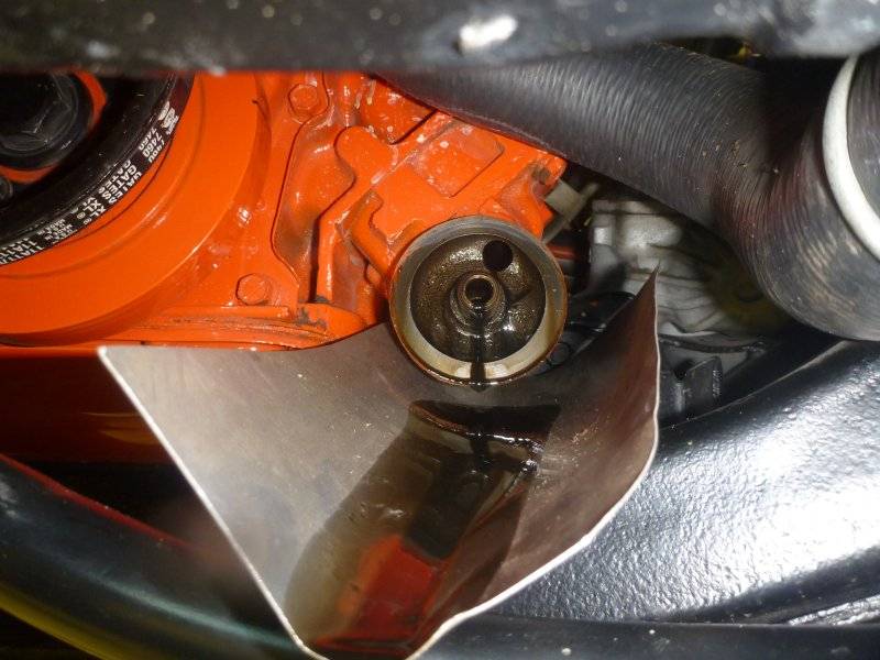

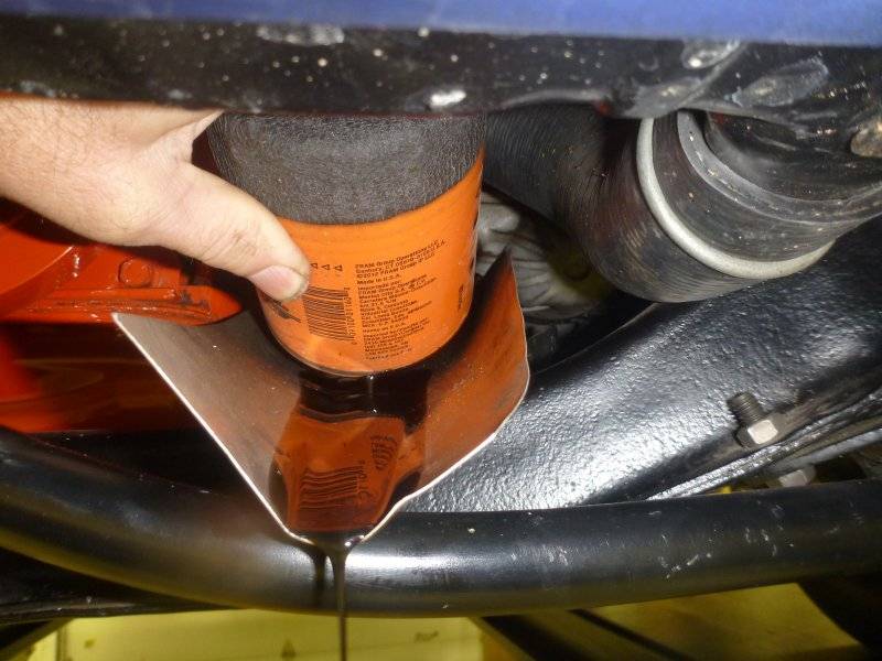

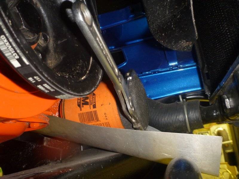

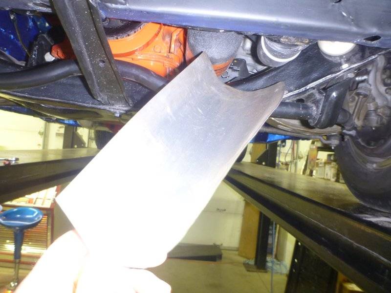

That’s chute is real good idea. I was talking to a buddy of mine just now who says he puts rags under his filter on his 440 before changing it to soak up all the oil it leaks.
I’ve always got oil on my K frame when changing the 383s filter, but this time it was streaming off the K member when I fired it up. Next time I think I’ll put towels under it to save myself a panic attack!

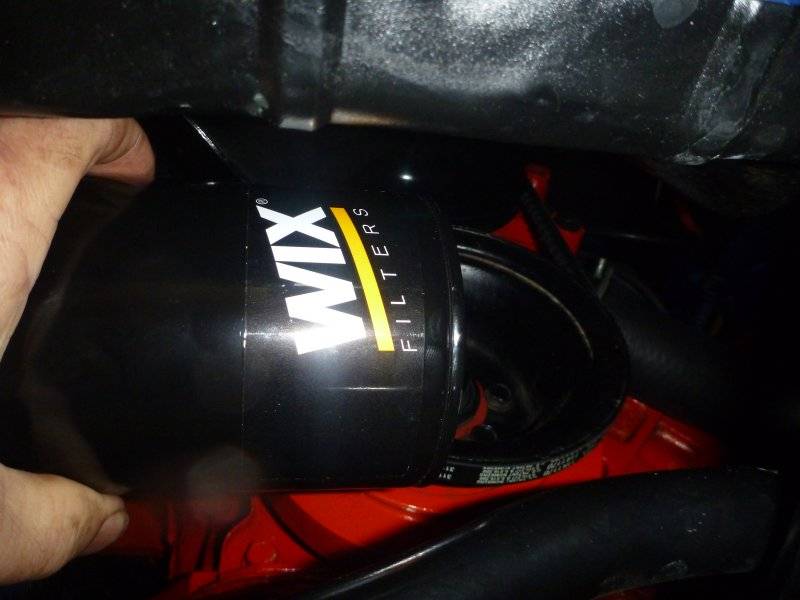

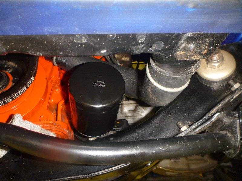

I usually use WIX 51515s on that car. I had some Fram TG8As I got on clearance a few months ago, so initially used one of those. I put a 51515 on it after my initial panic but don’t think it was a defective seal on it since the WIX appeared to be leaking too when I put it on second.
I've used that piece of scrap aluminum for decades. Not a drop on the car. I use the same one on my F150 Coyote engine and the father inlaws Rotax 912ULS in his airplane...
