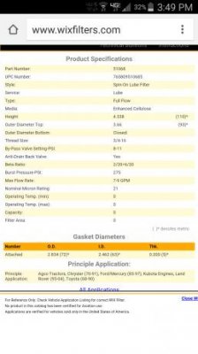

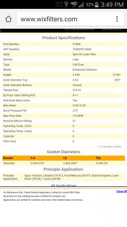

I just did a search on WIX for a oil filter for a 70 Roadrunner 440 oil filter. The one they recommend has a drain back valve FWIW Screenshot_2015-09-27-15-49-41.jpg
WIX 151515 or NAPA Gold 1515 listed as a Ford filter at NAPA has anti- flow back. I have used this filter since 1980 after a short battle with Mobile and their so called performance M1 filter that failed. I have never had a used 1515 tested but can varify it will in deed remain intact with over 80 psi oil flowing thru it. This is the filter I will continue to use. If you have something that works for you use it.
i know they advertise it but in the horizontal it doesn't work.
