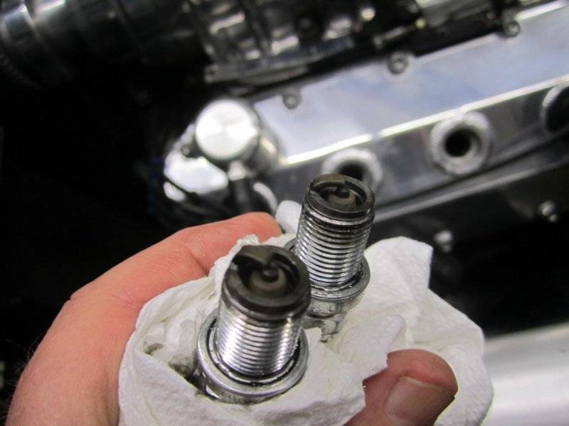

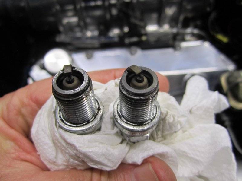

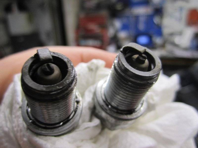

After the carb is tuned the plugs might just clean themselves.If they are wet when they come out,you must determine if it gas or oil.When you pull the plugs,make sure the rubber in the socket is tight! Soon as the last thread comes out the plug has to be quickly or oil will get on the tip,,,,,,,,,then you can't get a proper look at the plugs.

It wasn't the smell that over-whelmed us but the smoke that came pouring out and filled his work space. I'm a bit doubtfull of the fuel theory too OldBee because what dripped out of the manifold connection was too thick where it puddled on the floor. But - I'm all for and understand eliminating the easy stuff first before starting engine disassembly. He's going to pull the plugs tomorrow and I hope to swing by and see what that reveals.
Thanks
We had a much better day of things today and it looks like the motor doesn't have any serious issues. The plugs were very wet and fouled. He had put a big douse of CAM 2 fuel in the tank and apparently it doesn't evaporate like pump gas and leaves an oily-like residue for quite awhile. What was coming out of the exhaust manifold connection was gas run through the cylinders and exhaust. Some of the plus still had fuel completely spanning the electrode gap when pulled. The front carb has issues and leaks gas out of the left primary throttle shaft bore within about 60 seconds of shutting off the motor. Pulling it showed a wet gasket and lot of fuel in the intake. Cleaned the carb (did find some crap in it) and still leaked. Took if off and on 2 or 3 more times to lower the floats and examine things and still leaking fuel. So a friend is taking it to have the throttle shaft bushed.
