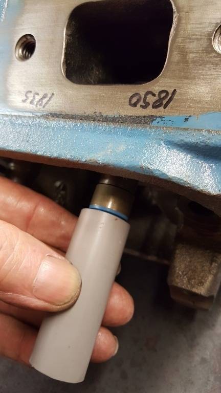

It will have to be the valve stem seals, if the engine is able to suck up that amount of oil through the inlet gasket every cycle the sump will be empty in minutes.
There is no way that the oil in the picture got sucked up and all got stopped there when the engine was shut down and the valve accidentally ended up fully closed.
Dripping down from a leaking valve stem makes much more sense to me.
