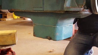

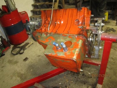

I just a need a tad more clearance:rolleyes: This is the old pan,,,,,,,,

I use the original stock K-frame in my 63 and I use the Moroso 7 qt oil pan. It fits with no mods at all and has never hit the ground as it has plenty of room. Ron

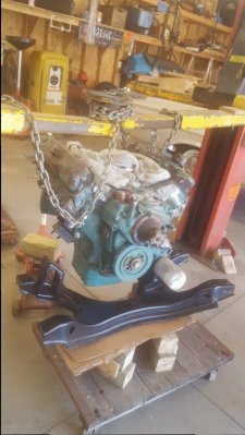

Did a dry fit on K frame . I believe the oil pan I am using from memory is a Moroso 8 qt pan from 15 years ago. It cleared by an 1/8 inch. I relieved it to almost an inch. I think this should be acceptable. Thunder

Glad to hear that. I think my Moroso pan is a 7 qt but it may actually be the 8 qt pan as I bought it around 2005. I know I use a stock dipstick and it reads full with 7 qts in it and the filter full. Ron
