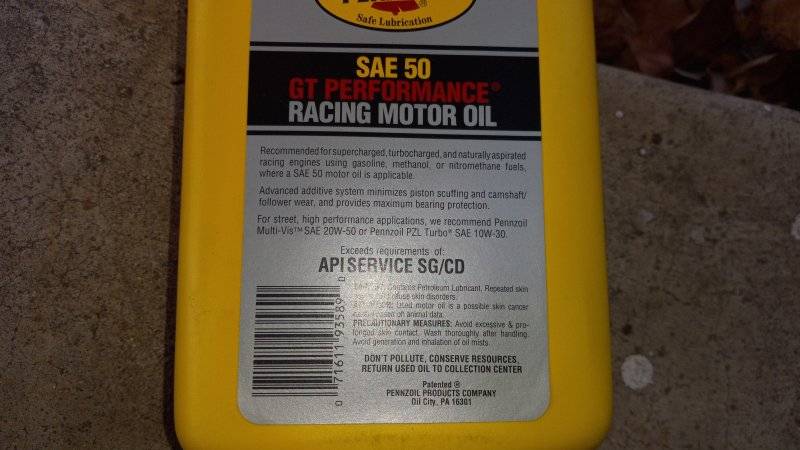

I was gifted a bunch of high-zinc SG racing oil, I think about 30 or 40 quarts. The trouble is its all crazy thick stuff, straight 50 weight. I'm using it anyway, a couple quarts at each change in my 440 bracket motor, along with 6 more quarts of 10/40 diesel.
(This stuff was originally used in a twin 454 racing ski boat)

I made an error. Almost half of the oil is SG rated.
Check these out… if nothing else, they’d be garage art.
Most of the oil you have (SG or older) is "Garage Art" as you put it. SG was obsoleted by API in 1993. So, your engine oils are 30 years and older. Probably not suitable for any car due to age (additive dropout may have occurred among other things). Your Red Line oil you have in the first pictures has the API donut? If not, it is not licensed by API. The SN category was issued around 2011. There has been decreasing phosphorus levels in engine oils (ILSAC and API) for about 30 years now. There was a flat tappet test (Seq. IV) using a Nissan engine that is/was part of the subsequent oil classifications to ensure backward compatibility for engines using flat tappets. Most of the changes in the categories (ILSAC GF-5 and GF-6/API/dexos1) in the past few years have to do with LSPI (Low Speed Pre-Ignition) and Timing chain wear that can be a concern in Direct Injected (DI), Turbocharged engines. Hope this helps.

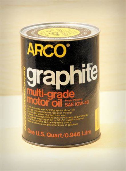

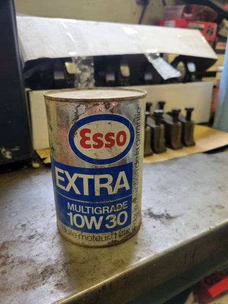

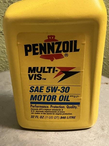

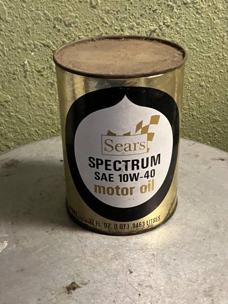

Today I stumbled upon a small stash of UNused oil in bottles that had no date code on them but did have the SAE API circle with ratings of SD and SF.
I thought that I was told that the higher in the alphabet the second letter was, the higher the detergent level.
In short, an oil like this:
...with it's SN rating is a MUCH higher detergent oil.
If this is true, what other characteristics could be said about this older oil? Is it possible that it may have a higher Zinc count as well?
I ask because I suspect that as the oil market adjusted to meet new car emission standards, they also included roller lifters that didn't need the cushion effect that was crucial for flat tappet engines.

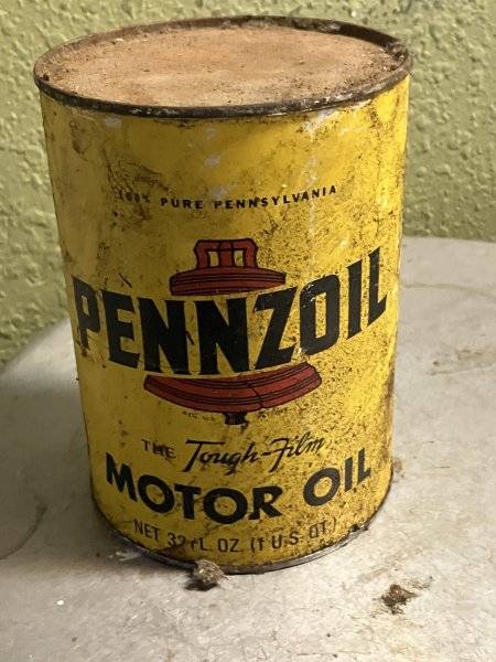

I have 20 quarts on unopened "classic" oil that have either the API SD, SF or no rating at all. The oldest oil that I got is in cans!
I don't intend to use this in my red car. I use "Driven" oil simply because of the stiffer valvesprings and solid lifter cam.
I have a few other lower performance flat tappet cars out back that may benefit from an older formula of oil. They do all have softer valvesprings which probably saves the lifters and camshaft from excessive wear.
What say you? Do you think the lower detergent oil may carry a higher amount of Zinc/ZDDP ? How would it even be determined without an oil analysis?
