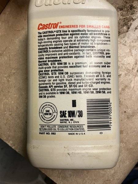

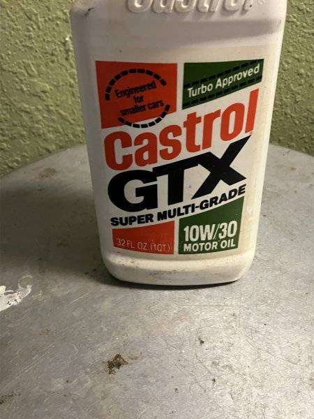

One thing I might add, KD,
is I've not added ZDDP to
to the Castrol and it has
survived thru more than
150,000 miles of severe
duty use.
I've added ZDDP to the oil
in my freshly built 440, but
mainly for break in.
After about 1,000 miles I
plan on running no additive
using Castrol GTX 20w-50.
Do you think the lower detergent oil may carry a higher amount of Zinc/ZDDP ? How would it even be determined without an oil analysis?
I would love it if you would send some of that oil off for a VOA. (Just be sure to shake up the bottle before you fill the sample bottle, in case some additives have settled.) I personally think there's a lot less ZDDP in these oils than many people believe...would like to know for sure. Amazon has the WIX 24077 Kit for $24.99.
