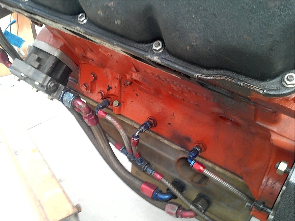

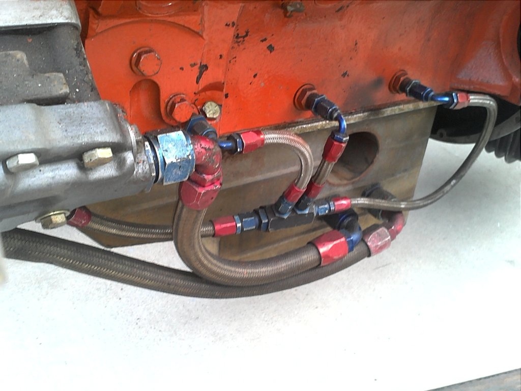

If your still concerned about oil to the crank you might look into an older mod of oiling the mains through the maincap crossbolts. At least the three mains with those bolts. I have that set up on my 64 Plymouth and I do get some comfort from that direct oiling when that big dual external line system takes its sweet time to register pressure.
I've never heard of oiling that way. Do you have any information on it?
We run a accumulator w/ a pre-luber so when the motor is cold I can make sure I have oil to all the bearings before the motor turns over. I wouldn't build a race motor with out one.
Thanks
K B used to have a side oiler kit. Thats what I have in my Belvedere. Kit consisted of fittings,hoses a block and 3 gun drilled side bolts. Still needed caps drilled and bearings too. If you have an older KB catalog its in there. I think I have a picture of my set up in my photo garage,64 Belvedere. I also have a similar set up on a JP-1 block thats apart. I can take a look at the main caps to see how they are drilled and post pics if your interested. Hell, I havent even looked closely at that block,dont know if they are even drilled.lol.
Yha, I like to see it for future reference. I clicked on Budnicks link but there are no pictures.
Thanks guys.
My plymouth motor oiling set up.
Why on earth???? Did someone try and re-invent the wheel on that? Stock hemis aren't restricting any oil to the top end. The cam journal is grooved on #4 for full time oiling. It doesn't need it. They should have left it like the wedges. I run the RBRE rockers with spray bar oilers in the bed plate. Highly restricted compared to stock. No issues on the street.
Hemirunner,what exactly do you mean? The pictures show a mod for oiling the mains. KB and others have this available. And now its built into many blocks with a passage running along the skirt.
