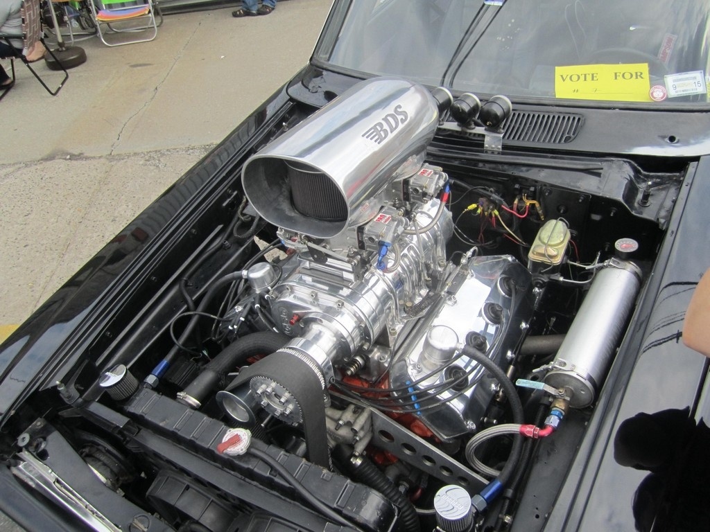

How much are you willing to take to part with one?I have 2 new accumulators I'd part with. A 3-quart Canton and a 3-quart Moroso. I never used or needed them. I've always had instant oil PSI on start-ups.
Let a motor set a while. It will not have instant oil pressure. Also external line systems are notorious for losing prime. Being that replacing my motor would cost north of $20K in parts alone I'll use the acumulator.Accumulators sure seem like a good safety feature. When I was bracket racing every weekend I considered the value, but never installed one. I thought that real value was not on start up, since I also had instant oil pressure, but if something failed during a run, you'd have a bit more time before total destruction.
