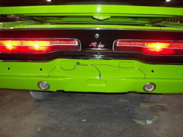

I've pretty much got it wired...I hooked up my jump box to it to test everything, I got an issue with the front park/turn signals, I've narrowed it down to the front light harness, got to pull it back out, unwrap and find the problem. I re-placed the engine harness with a new one from YearOne, but all the others are the originals because they were in pretty good shape, probably the front light harness was the worst, so Im gonna unwrap it and find the problem....

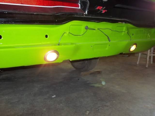

Taillights, backup lights working.......ITS COMING TO LIFE!!!!!!

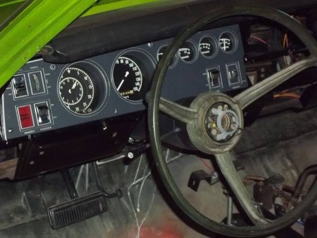

Cluster in.....I bench tested my clock, and it worked. when I put it in and hooked it up the second hand ran real fast, go figure. When I tested the wipers they ran, but when you turned it off, they wouldn't park. So I pulled the cluster back out, wiper switch had a terminal broke off, so I dug around in my parts pile, found another, cleaned, tested, installed it, now wipers work correctly. Pulled out the faulty clock and installed a nice clock delete I had for the time being (don't have a pic of it yet) Plan on putting in another clock or tach later, got a green duster steering wheel I have, temporarily installed until I get me a steering wheel, LOL...

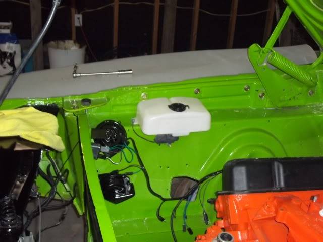

Horns, Horn relay, washer jug, washer pump installed....

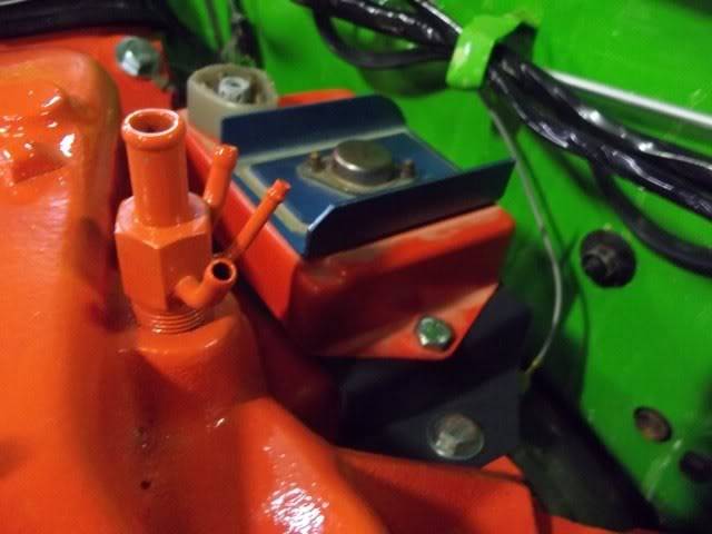

Ok quick story, I was trying to find a place to mount my ECU since I converted to electronic ignition. Ive seen those cool bracket/mounts on eBay that mount on the rear of intake on the valley pan hold down strips....well those things on eBay for $20ish plus shipping, well me being cheap and wanting it now...a piece of scrap sheet metal, bench vise, body hammer, 1/4" drill, black spray paint, 30 minutes later....VOILA......

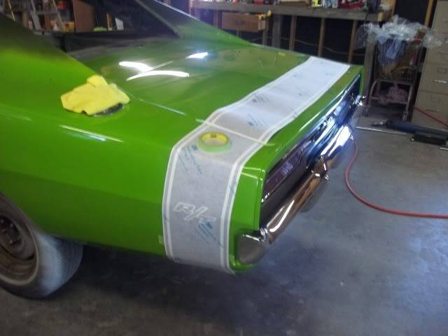

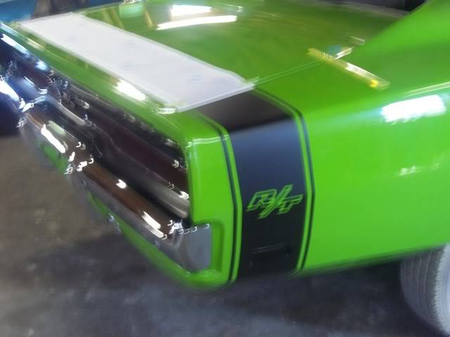

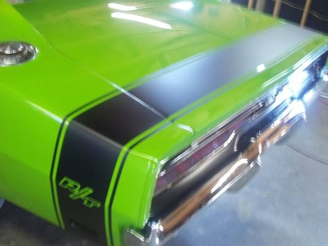

New AMD rear bumper and rear tail stripe installed........

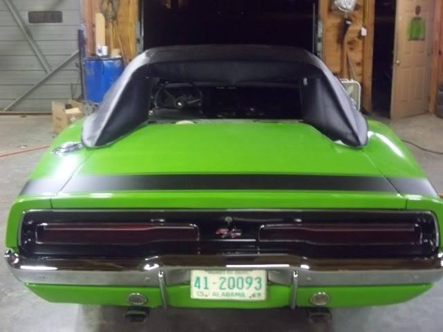

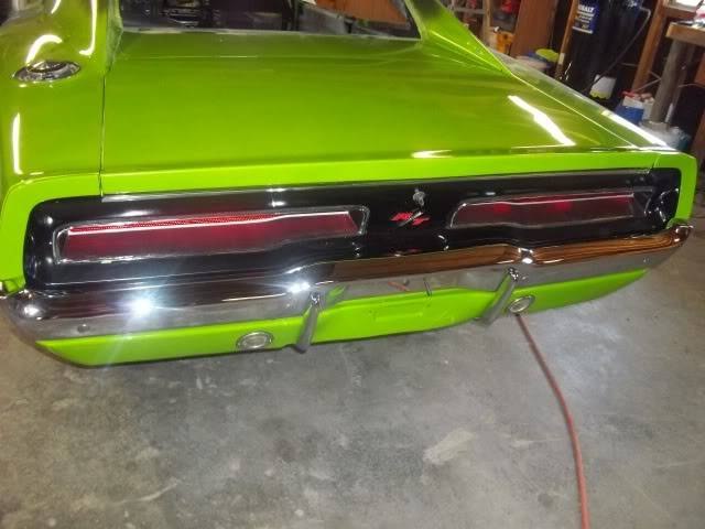

Been a while since I've updated, after installing stripe and bumper, I installed the exhaust system I bought off eBay. It was a reproduction system and fit pretty good, the left tail pipe give me a little problems, but I got it in. I installed repro exhaust tips from eBay seller stripeclassics (nice tips) and I bought some new tip hangers from member Back in Black (thanks for the deal!). Here is a pic of the rear of the car with exhaust/tips installed. Also note in the pic the license plate, in Alabama now you can run year of manufacture plates, a friend found this 69 Alabama tag.

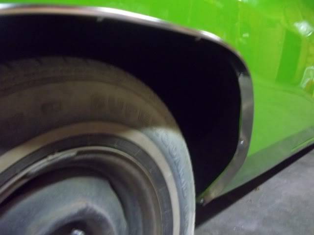

I also undercoated the rear wheel wells and installed the wheel lip mouldings....

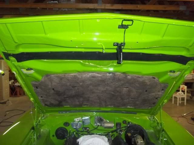

Installed hood pad, core and cowl seals...

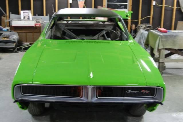

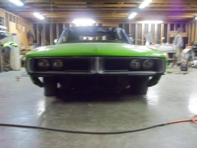

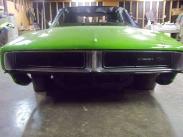

BIG MOMENT, got the grille installed. The pic in my signature was taken not long after paint, just the grill held in with a couple of bolts. Its now fully installed with all the headlamp parts and hardware....

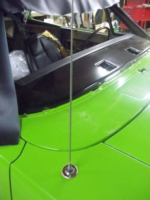

Scored a very nice used antenna on eBay for 32 bucks....

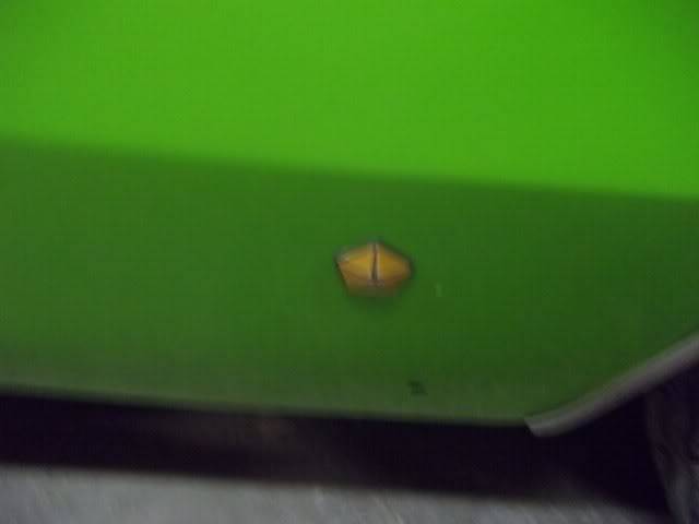

Fender pentastar....

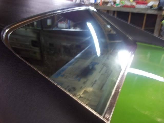

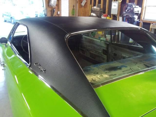

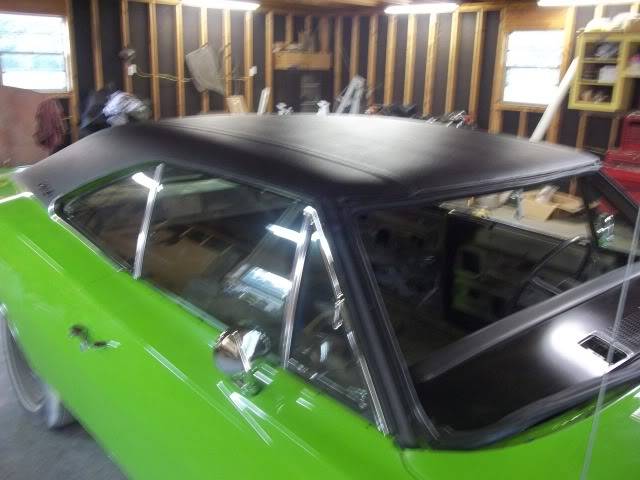

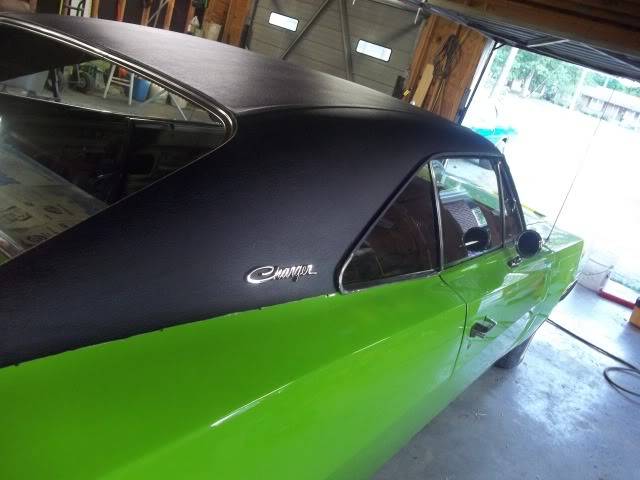

Had a friend that owed me a favor (put a waterpump and brakes on his van) So he bought me some 3M adhesive and come over to give me a hand installing the vinyl top. The hardest part was the upper-inner corners of the sail panel, after a little cussing it was all good....

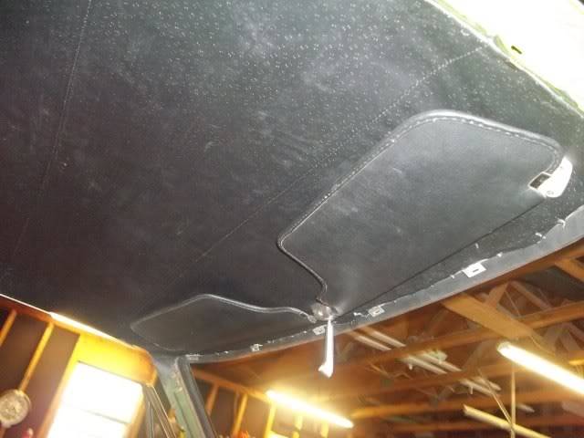

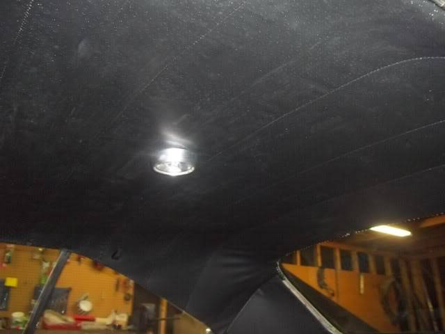

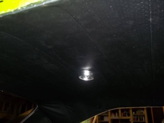

....then onto the headliner, I cleaned up and reused the original sunvisors, after a little elbow grease they turned out like new...

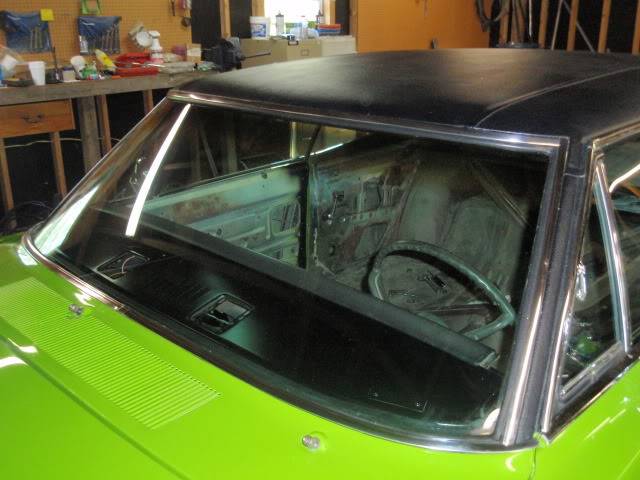

With the help of my lovely assistant (wife....thanks Alesha!) we installed the backglass and trim....
Then a couple of days later (again with wife's assistance) we install the front windshield....

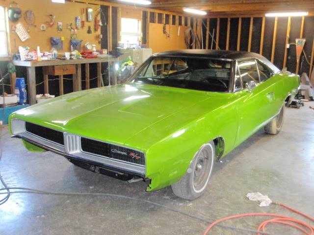

Here is how the Charger looks right now, I polished up all my original trim, it was in good shape to be original but there is a piece or two I may replace later on down the road. About all that is left bodywise is buy the front bumper, install it and the front valance. Buy rocker moulding clips (have new repro rocker mouldings), and buy/install side marker lenses. Other than the headliner, I got to buy and install most of the interior.

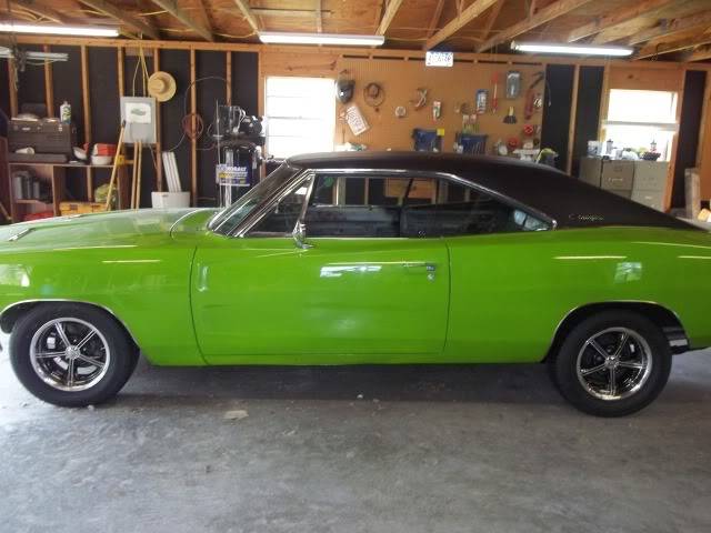

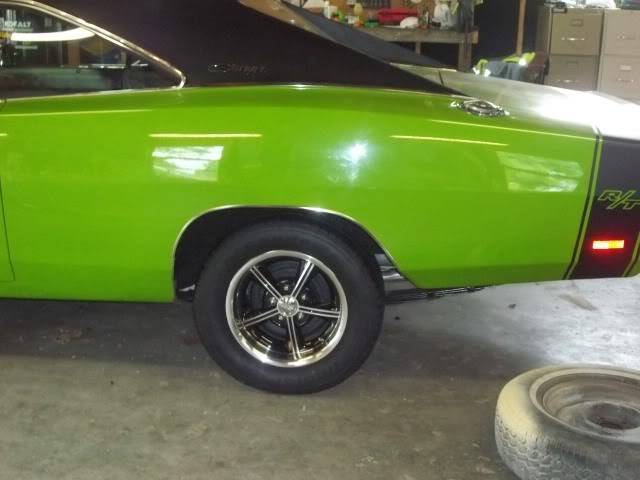

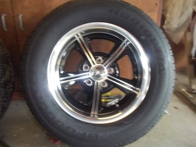

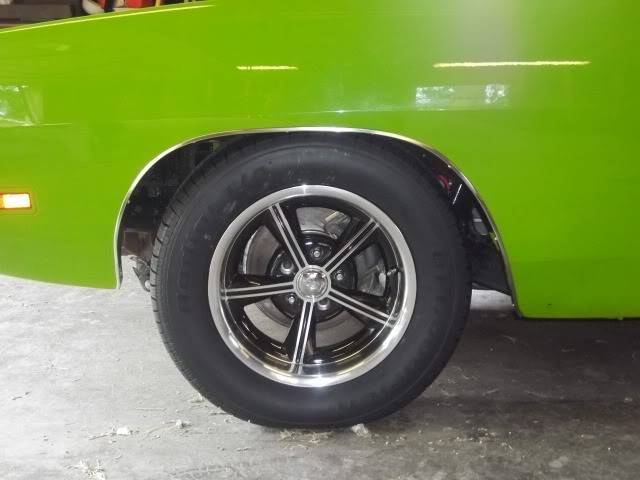

Well, stuff has started showing up, today my wheels came in. They are ION 625, 15x7, I really liked these wheels, sort of has a Magnum look to them, but look more current. I went to the local tire shop, and had 235/60-15 BFG's mounted on them. Had to throw a pair on and snap some pics. Totally changes the 'attitude' of the car.

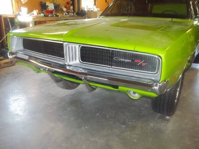

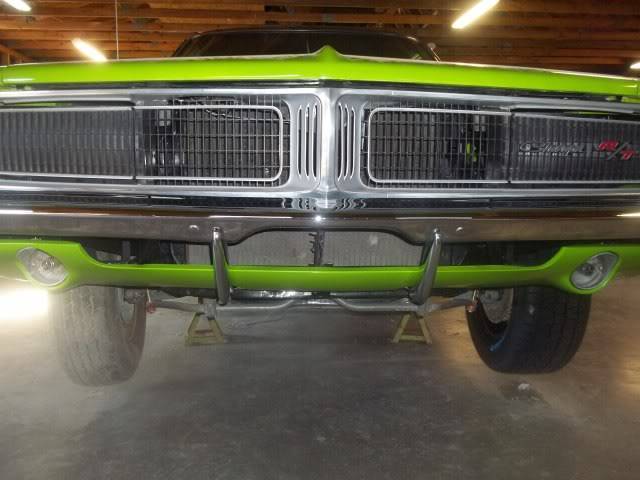

Installed the bumper brackets, AMD front bumper, front valance and front turn signals...

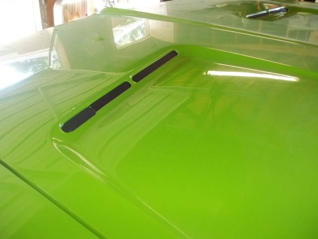

Installed the decals on the hood scallops...

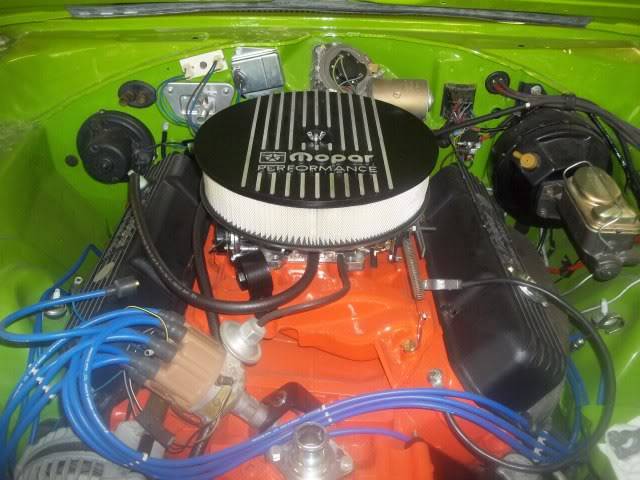

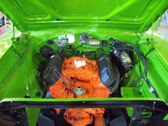

Took a new pic of the engine with new air cleaner. I bought the MP to match my valve covers...

how hard was it to install your vinyl roof? did you just lay it out on the roof,spray the sealant on half at one side?
