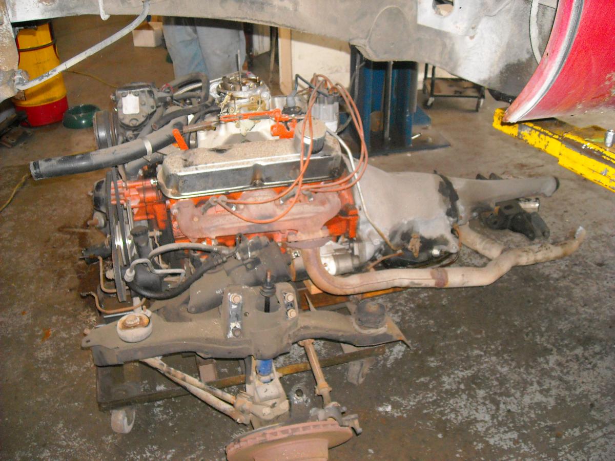

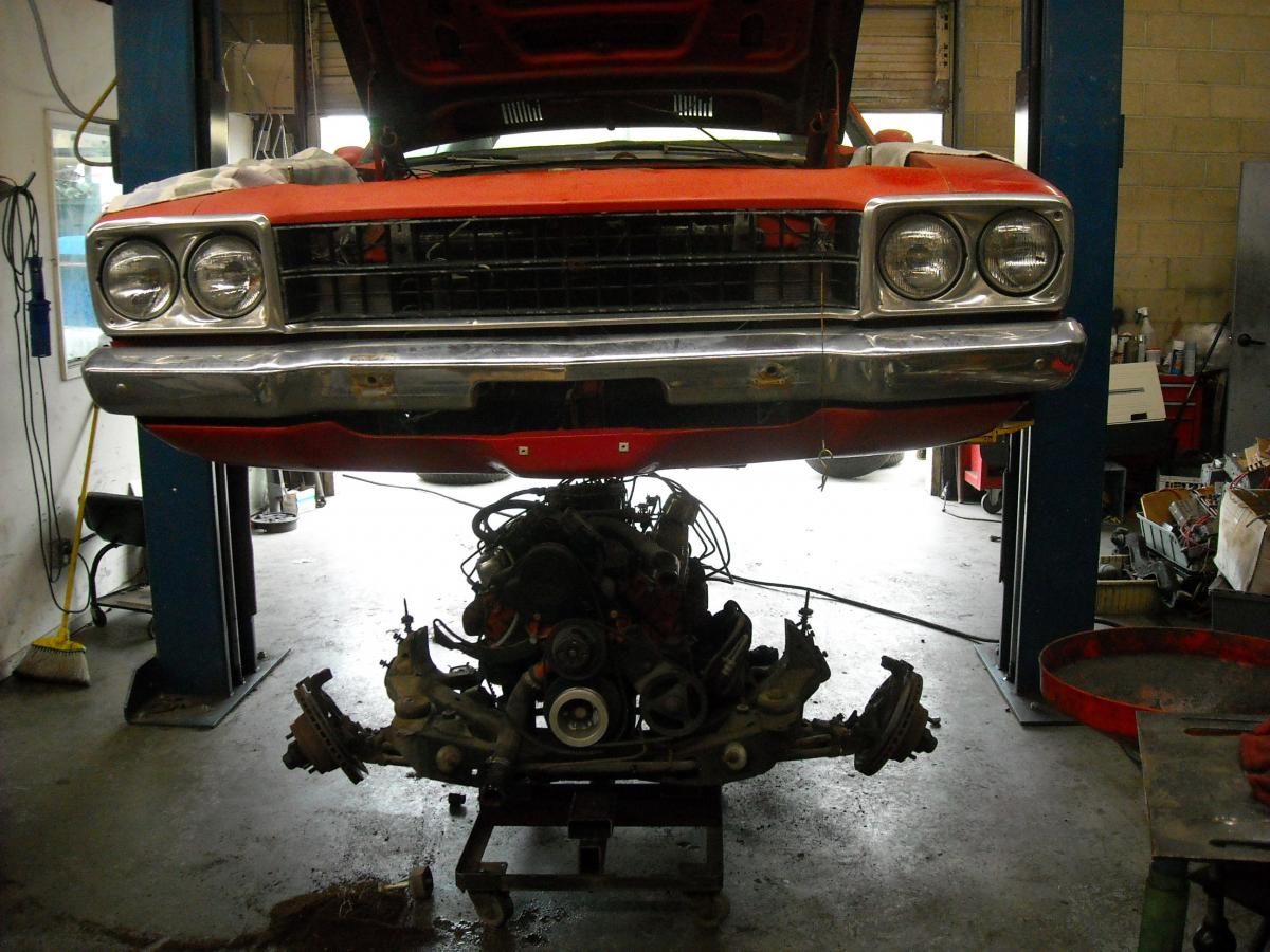

So, here we are, a few days (?) later. Finally got the bird on the rack and the old mill out. One step closer to heaven.....
You can never have too much assistance, right?
One thing worth noting at this point. I had never done a swap on a Iso-Mope before. I've done a bunch of earlier cars by dropping the motor out the bottom complete. On the Iso-Mopes, it would appear that you have to remove both the upper control arms and the T-bar crossmember. 'Nother side note: I am putting solid bushings on the K member that I got from Cudazappa on the A body site. It looks like the T-bar mount can be solid mounted with some first gen Camaro body mounts. I'll be checking that out shortly......
