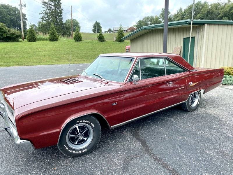

Ok serious question for the crowd.
Air cleaner pie tin is off and hanging in the garage. The risk of chipping paint wasnt worth the emblem change to me

440 engine callouts were never put on 1967 Coronets, not even R/T's. They came on a few Chargers and Monacos. My vote is to leave it as is, if you are selling.

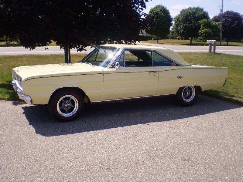

1966-67 383 4-barrel Coronets had engine size call-outs on front fenders, as did 426 Hemi. Only call-out on '67 R/T was for optional 426 Hemi. I have never seen an R/T with just V-8 sign on the fender. Mine does not with standard 440.
This is the truth. 426 Hemi only on R/Ts
. The 440 Magnum badges were on Chargers. I put a set on my 67 R/T just because I like them, and had seen another 67 R/T with them at a car show. And, one of the first car shows I put my car in, an older guy called me out about them not being correct. I said YEP, and I wasn't trying to pass them off as original. It's my car, and that's what I wanted...

I have a 440 monaco that someone put 383 emblems on, and the holes aren't the same.
Had a chance to double check and the the answer is , no.
If you wanted to put 440 emblems on, you will have to either;
Drill, weld, body work
Or, grind the teats off and double side tape them on.
Sorry to be a party pooper

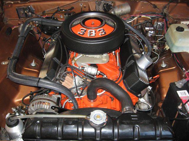

My Charger has a 361 masquerading as a 383, since the previous owner added the 383 fender emblems and pie tin. I guess it is karma because my previous Barracuda had a 500 stroker masquerading as a 383.

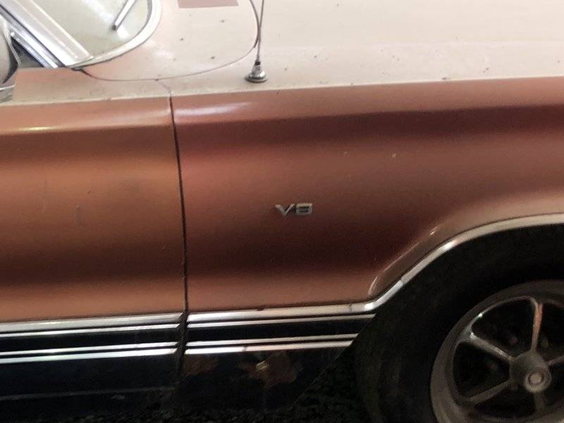

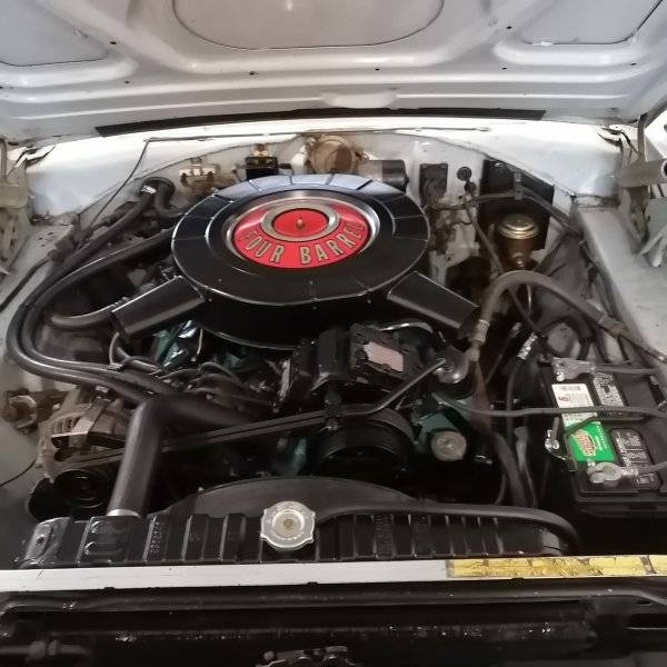

I've been tempted so many times over the years to simply replace the "V-8" emblems on my 361 '66 Coronet with a set of NOS "383 four barrel" emblems I've had since 1985. But instead, I had "361" hand-painted above the "V-8" callouts when I had the car repainted in 1985. Most have no idea what a "361" is! I've had "what's a 361?" and "don't you mean a 360?" Had a Ford guy ask me once "A 361? You have an Edsel engine in that?"...uhhh, no.
You couldn't get a 273 HP 4 barrel engine in a 66 or 67 B body, so the 273-2 got "V-8" on both Dodge fenders and Plymouth hood ornaments.
On the Plymouth hood ornaments, all other V 8 displacements got the size numbers. (225 cars got a blank backed ornament in 67)
66 Plymouth 361 and 383 (remember only 4 barrel 383's in 66) both got "Commando V8" rectangular badges.
