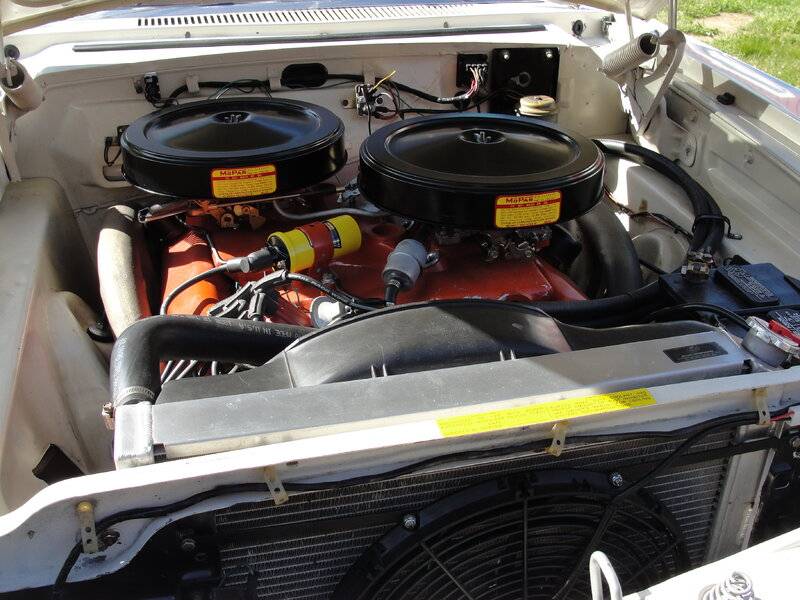

Thanks again for all the great ideas. Sure making the youngings smart these days :) I ordered the base heat insulators, I think they might help. Here are a few pics of my baby.

I went to Amazon and ordered and received the heat insulators. put them in and they definitely helped. Running it every day is also making it happy and sure putting a smile on my face:thumbsup:. I think it's time to take it to a car show!
