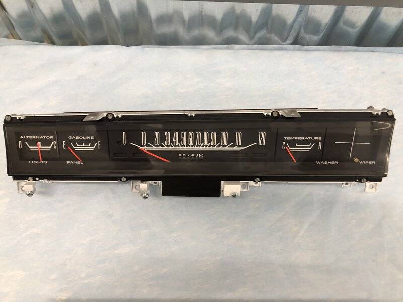

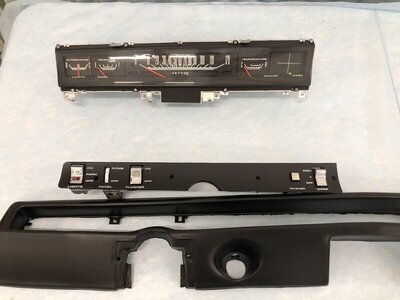

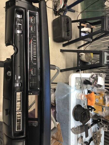

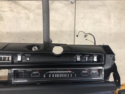

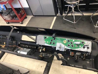

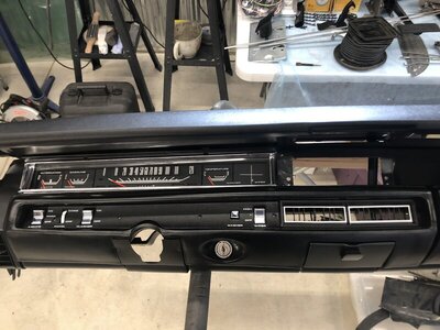

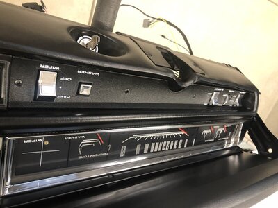

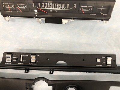

David Performance Car Graphics took care of the switch panel speedometer and gauges

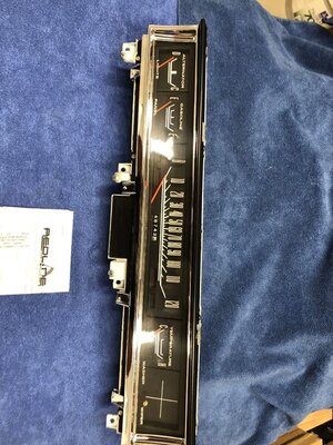

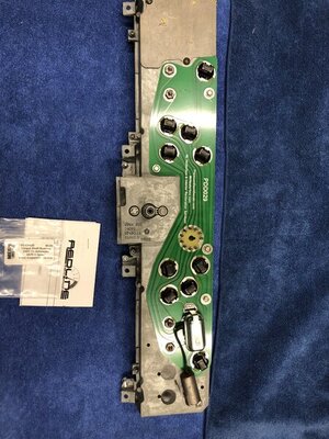

I also sent this to Shannon at Redline gauges for the amp meter to volt meter conversion no potential fires under the dash anymore.
I highly recommend both companies

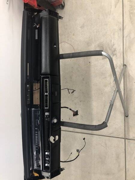

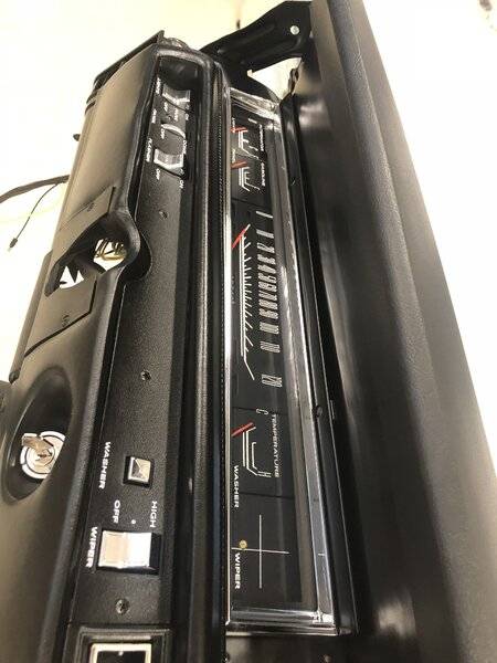

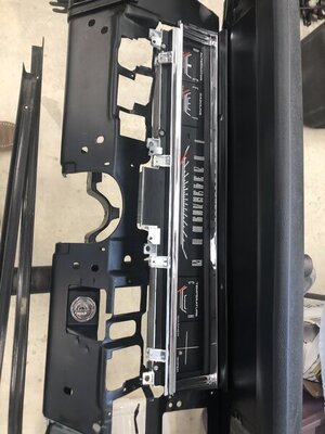

Starting assembly
The center AC vents have been totally restored and re-chromed gauge bezel and switch knobs also. GCAR does a great job re-chroming plastic.

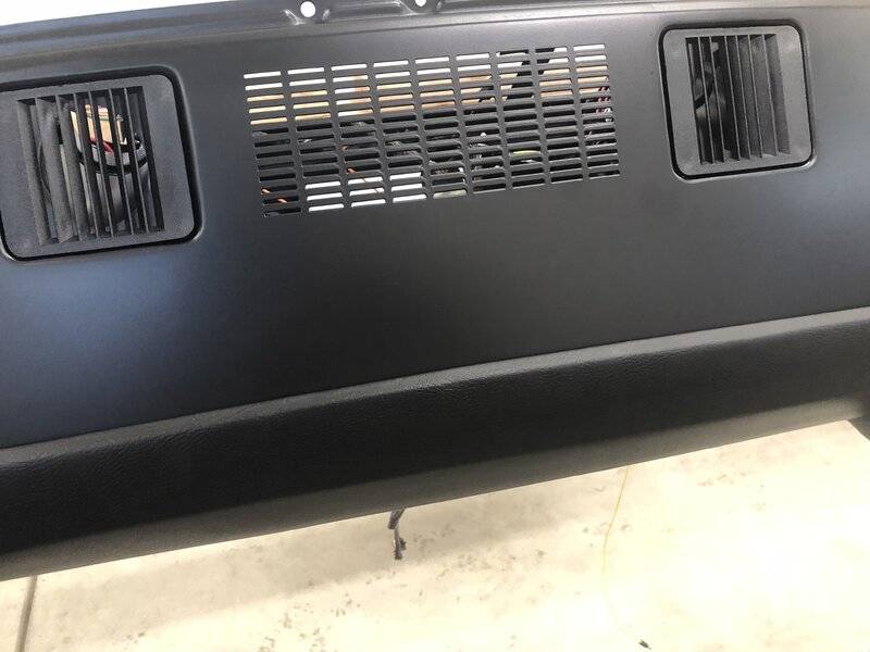

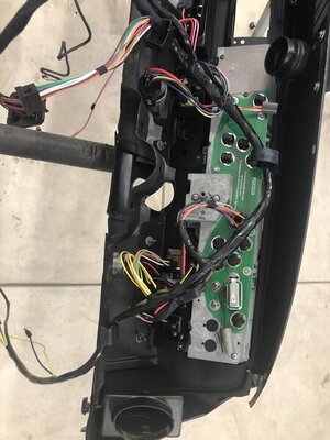

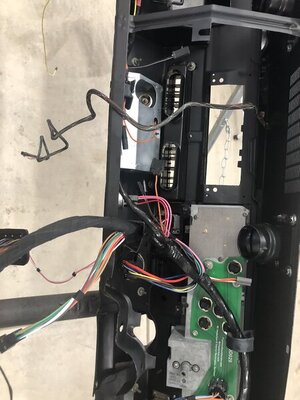

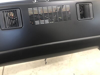

Installed new M and H wiring harness
I also use dielectric grease for all connections and double check that all wires are secure in their harness

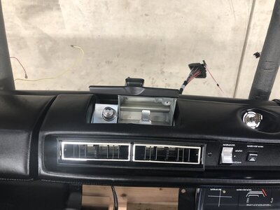

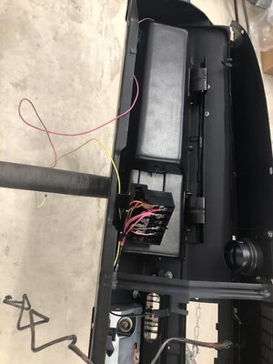

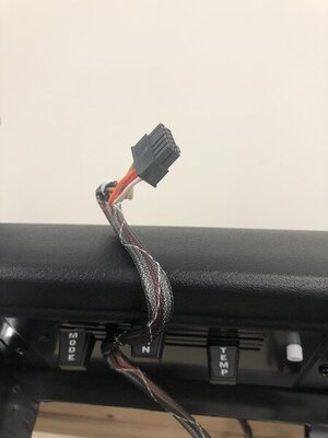

Some shots of it all coming together I am using a Vintage Air system you’ll notice their control in place of factory unit
E0C2A5A8-D60F-4F8A-A990-1F9E3AC6B872.jpeg A978C5D2-D075-47D5-9D3C-EAEB58C37373.jpeg A6F457BE-59EF-4EE1-91D5-EBFE469581F3.jpeg

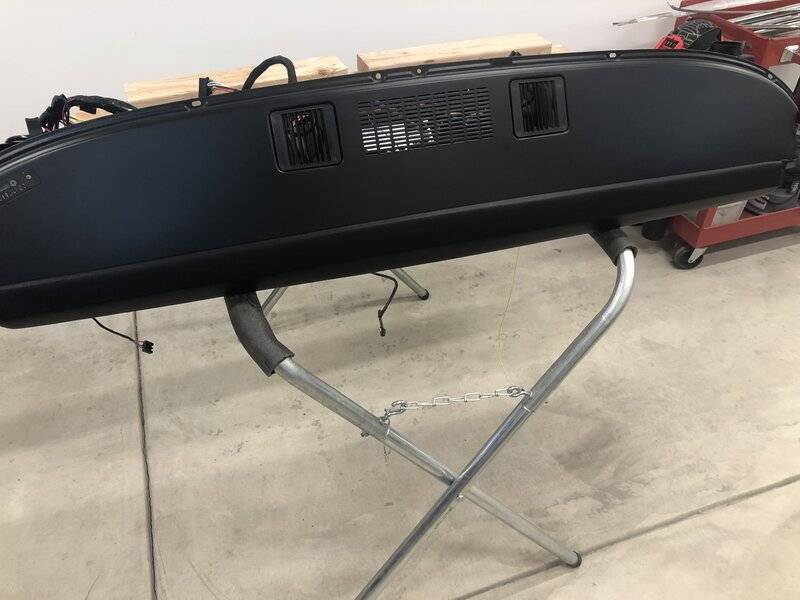

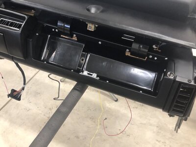

Here are a few of the Vintage Air pieces and the new glove box injection molded plastic. I am very pleased so far with the Vintage Air system highly recommend it if you’re not trying to be perfectly stock. I’ve done that before too.
Also you’ll notice the AC vent adapters

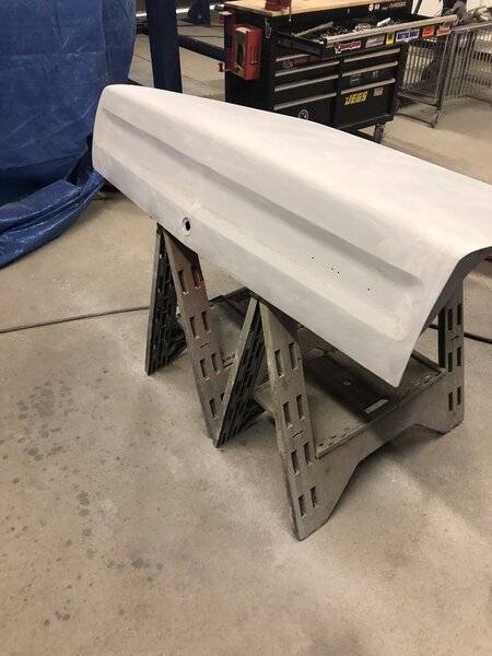

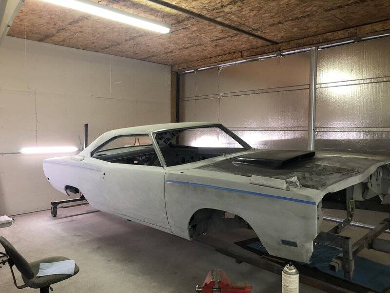

Here’s an update on some body work and paint

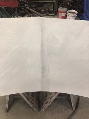

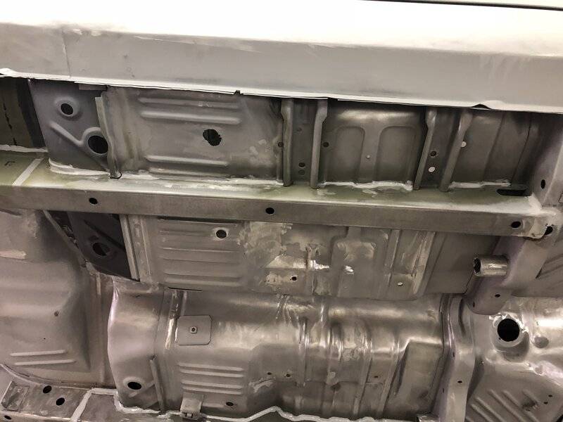

Doing some blocking on the body lines
21C884AE-5316-402A-9FA5-4C850BC849C5.jpeg 2402F688-349B-4156-92A8-91B1CC957FB1.jpeg

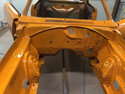

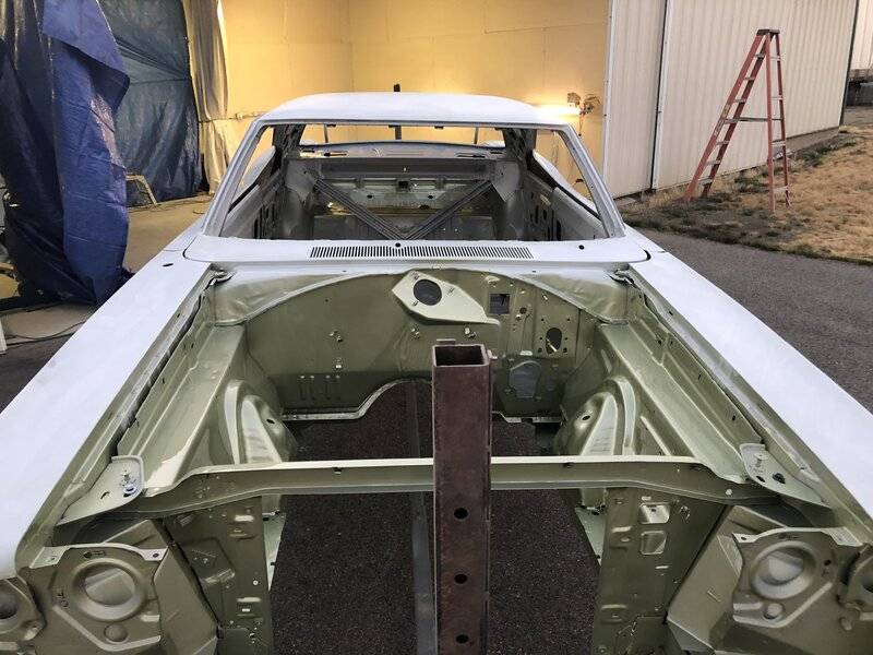

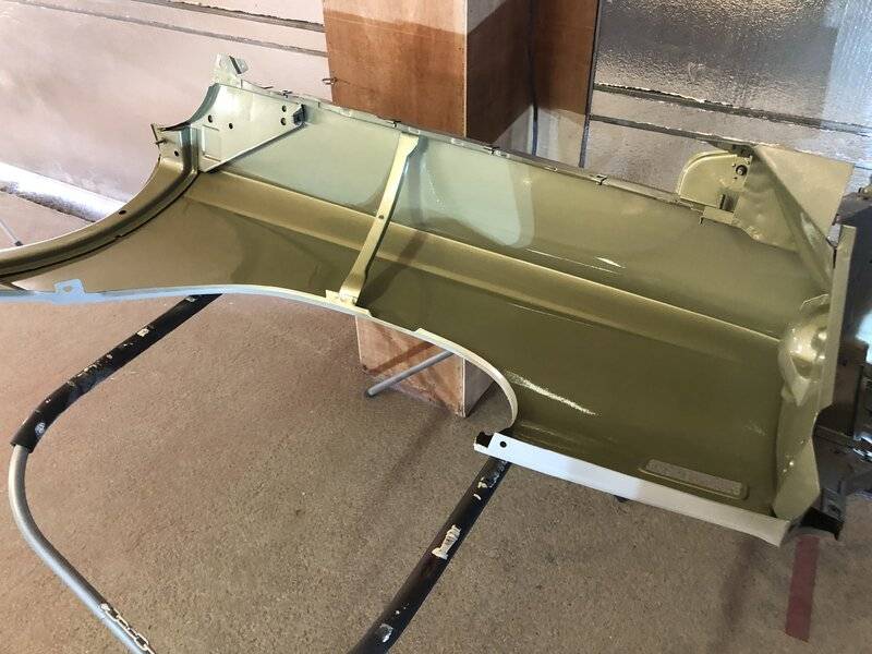

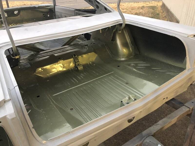

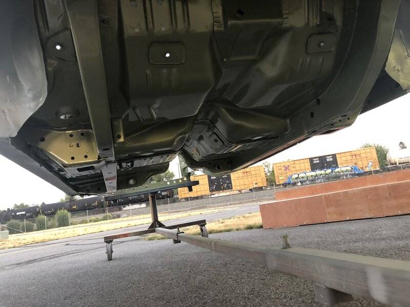

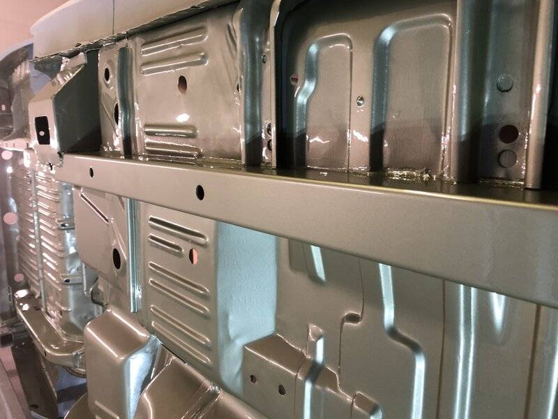

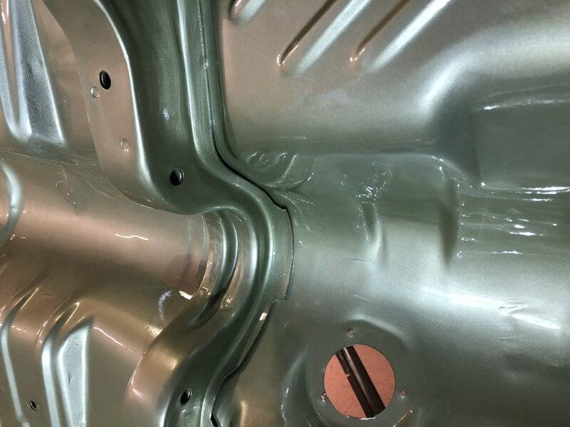

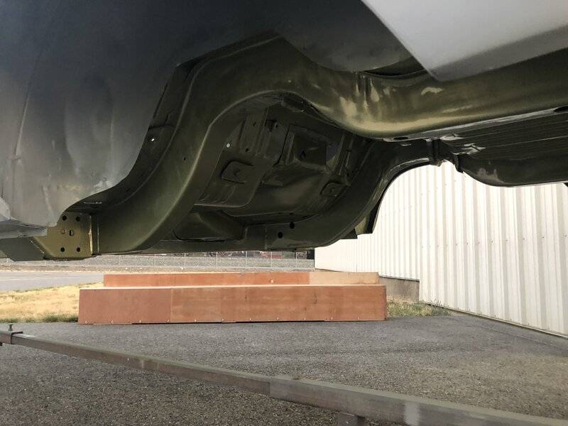

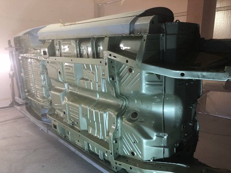

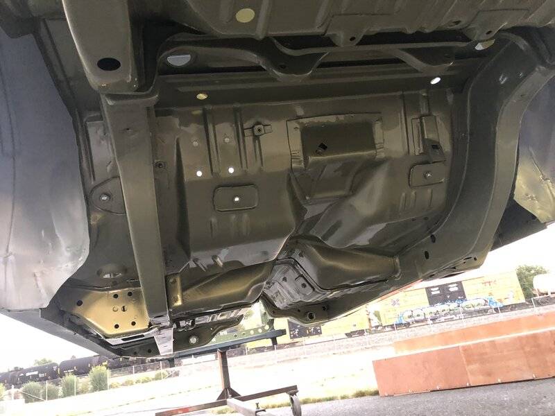

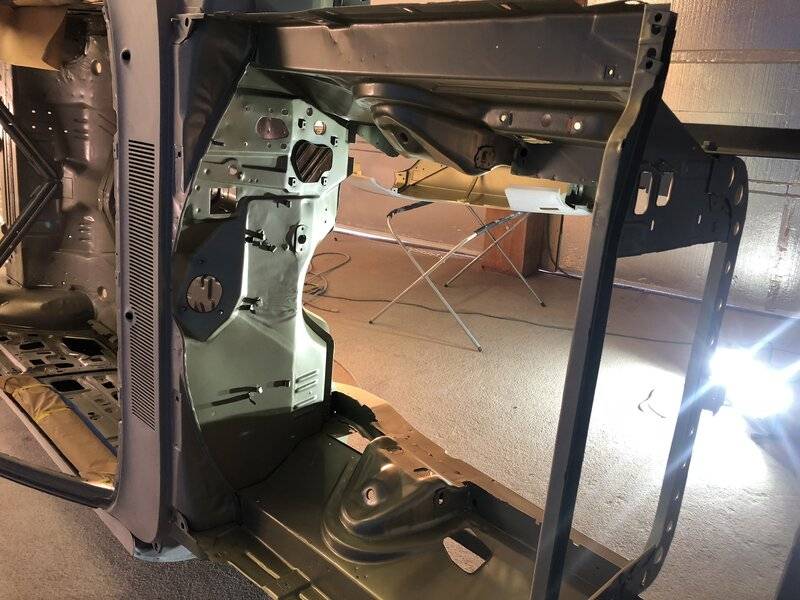

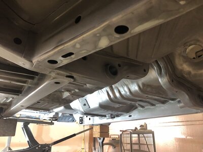

Starting to paint underside trunk and engine bay
F3 Frost green. This was the color of my Dad’s A12 that I am paying tribute to
D32823FD-FC99-4FEC-830D-5683DBCE4BD5.jpeg FE153796-4C0F-4E8B-8F91-2259C2E7AA89.jpeg D746DBCD-3C65-4122-945D-19C419972D91.jpeg 119EFF86-D15A-4959-B1D7-10C20118E0F6.jpeg

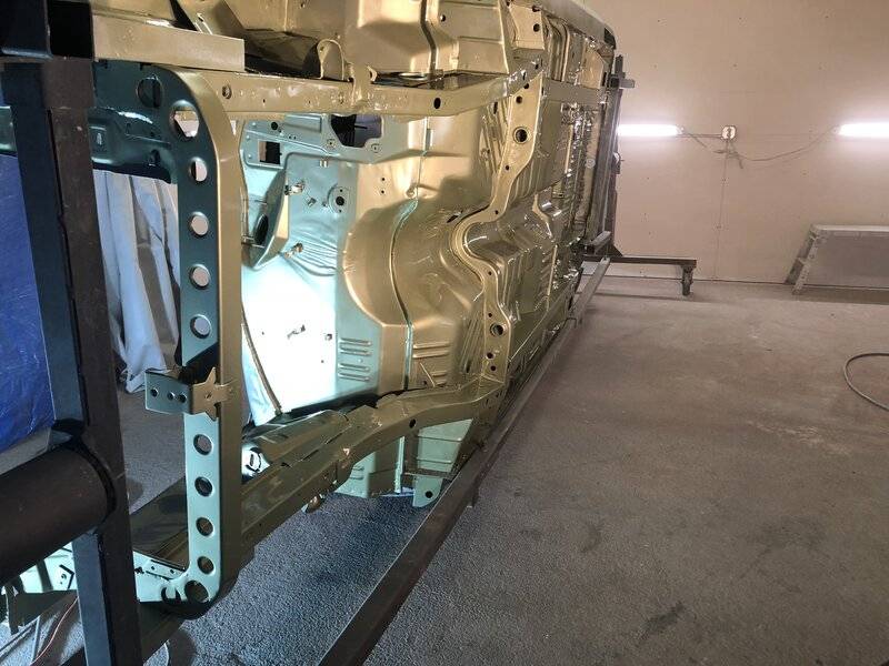

A few more paint pics

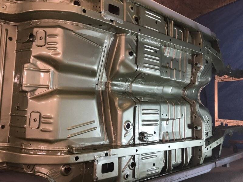

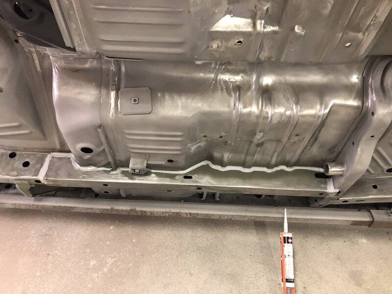

Notice the torque boxes have been installed at the spring perch location for Stiffing
25F28D79-BF36-48E4-8CB9-B9892477C9C9.jpeg B8359ADE-A23C-4E4C-8405-0E2B86D265C1.jpeg F06873BA-0158-41A0-A99D-A044322673B0.jpeg

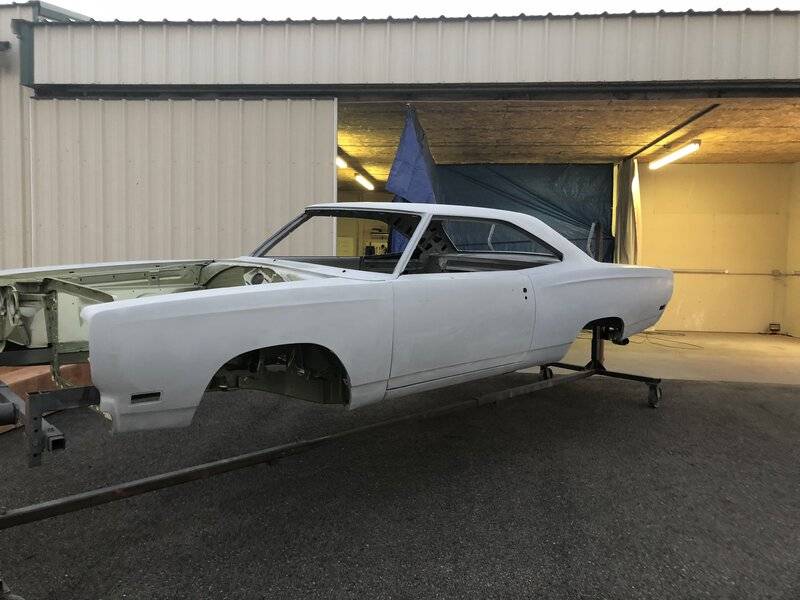

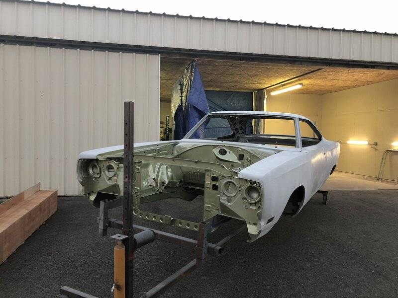

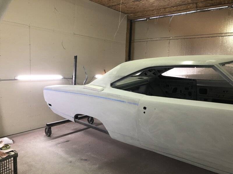

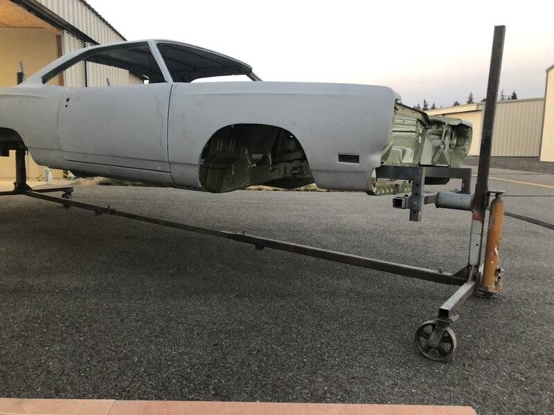

Some pictures rolled outside to give the body a final check before painting.
Trying to have the body as flawless as possible what a task

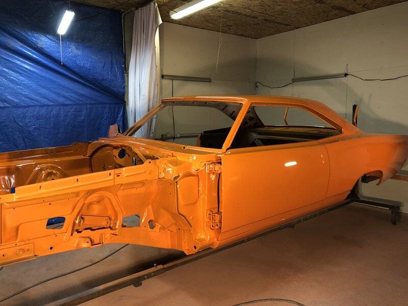

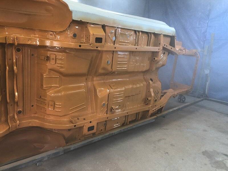

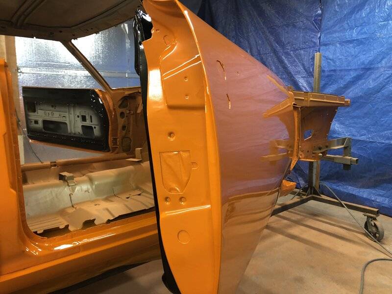

Sooo we scuffed what was painted green and are returning the car to Omaha orange as it should be.
D3CF4308-3148-480B-91AB-27D71B2BD674.jpeg 54E23858-C2D7-4C0B-87EE-401D4DEBD184.jpeg 61493B62-BEE7-4F40-8E6E-57BF849B700E.jpeg

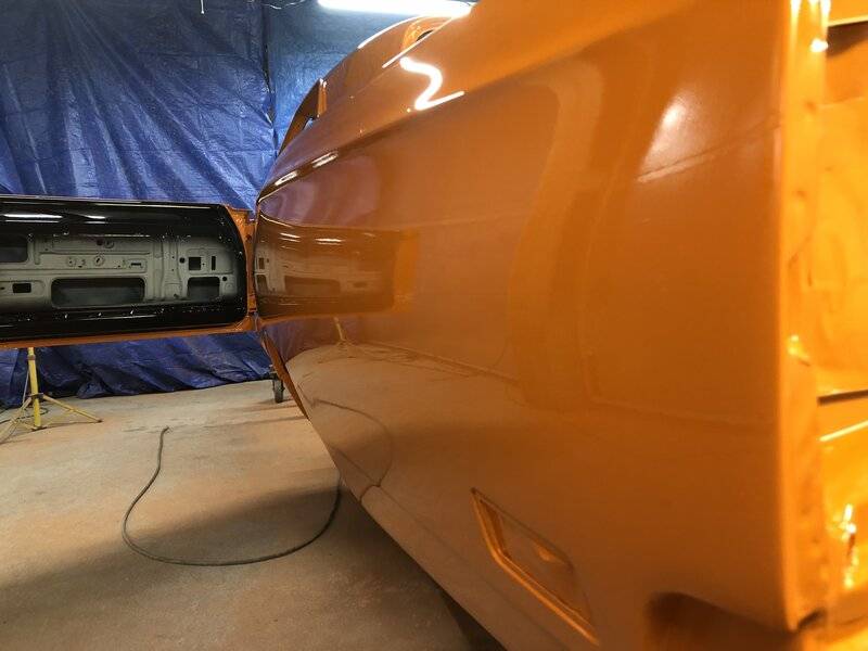

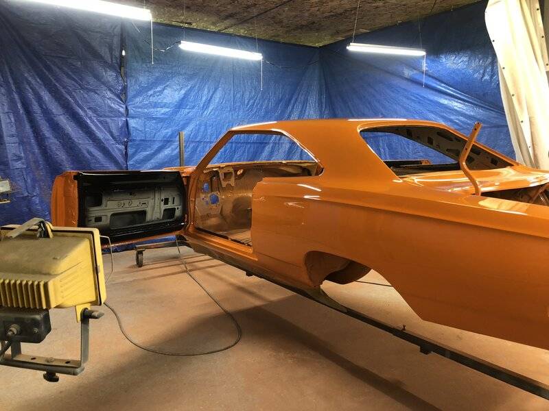

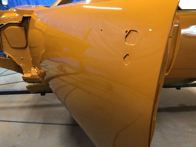

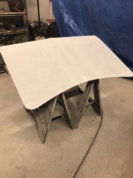

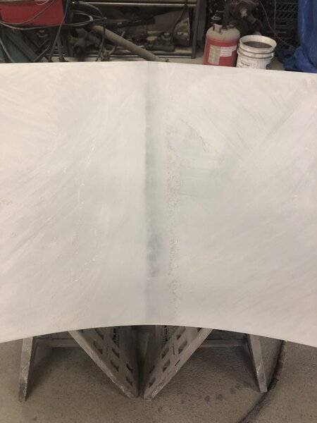

When you get the paint on the body is when you see all the hours of prep work to get it straight.
Came out great. Notice the make shift paint booth. It works really good.
