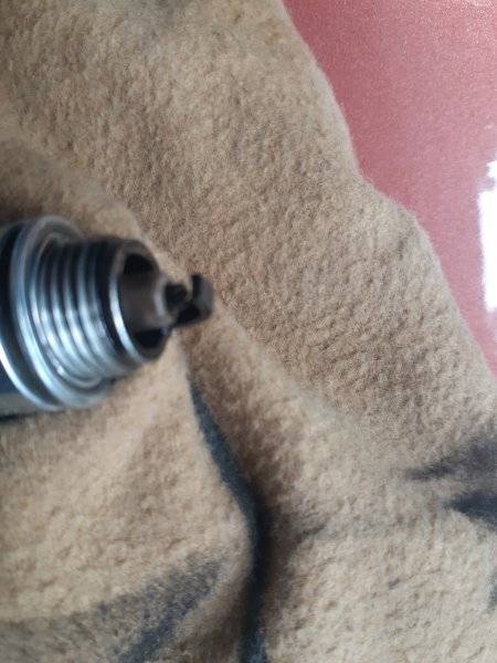

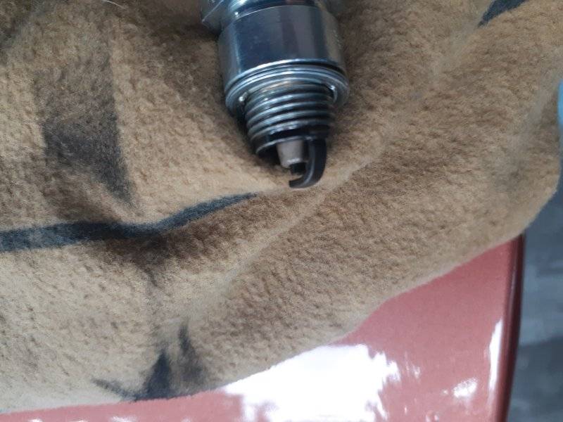

one plug not firing
If it's a shiny wet black more likely than not it's oil. Too much fuel on a healthy cylinder will be a flat, dry, sooty black. Get a picture.
it was shiny wet black on the porcelain. i will take some photos.

race tech forged Pistons. back out now working on it.no smoke out the tail pipes. The breather cap not pushing up with back pressure will run good till plug fouls. leaning towards intake gasket leak. going to do a complete compression test now.
plug is wet can't really smell gas
ok 165 cold same as other ones, BUT on the first stroke of cranking the gauge does not move like the other ones moves. no 3 only moves on the second crank.

Be sure to check valve seals. One indication of oil coming thru the intake port is the plug will show a wet bias on half the plug. If the rim of the plug has a wet clean section that would indicate a detergent oil cleaning the carbon off.

i did a leak down. It was the same as other cylinders. I'm going to pull a valve spring off and look at the seal I want to check the spring pressure too I never did when I bought the heads and forget what they were if they told me. then check the intake gasket. if the oil ring is bad would the cylinder still leak down ? no smoke out the tail pipe no air leaking out of the tail pipe from the exhaust valve.
The oil ring going bad by itself is unlikely. Do a valve seal check first. Also look for a cracked guide boss. Some people don't check retainer to seal clearance when upgrading cams. Too much lift will definitely clobber a seal.
