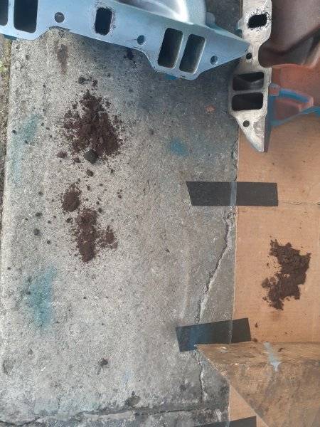

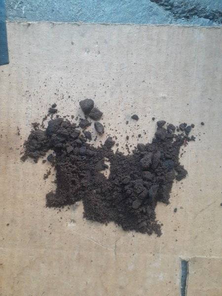

this was caked into 3 intake runner in the intake manifold needed a rod and hammer to get it out. what the hell is it ?
good thing it was hard and stuck together. what can I use to get the loose stuff out would a garden hose hurt anything ? used air but like to use something more.
