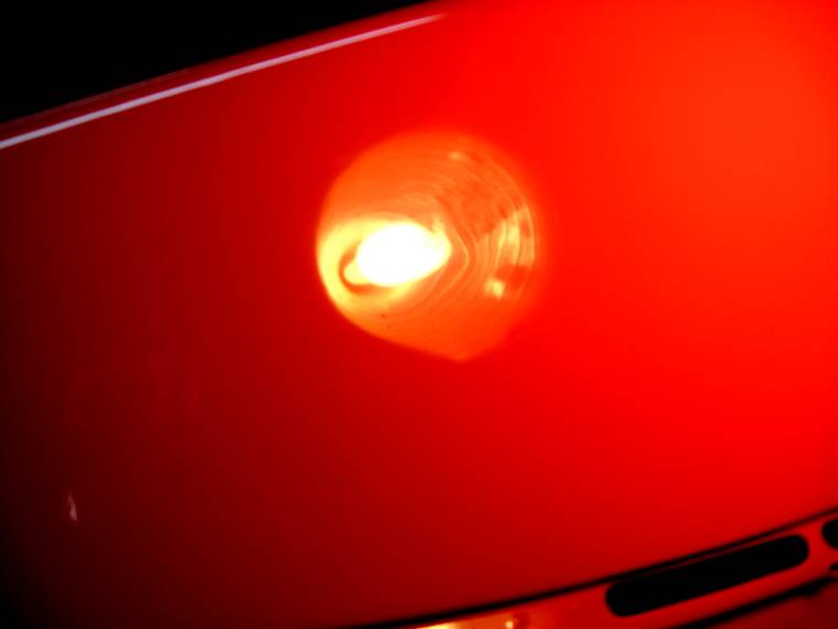

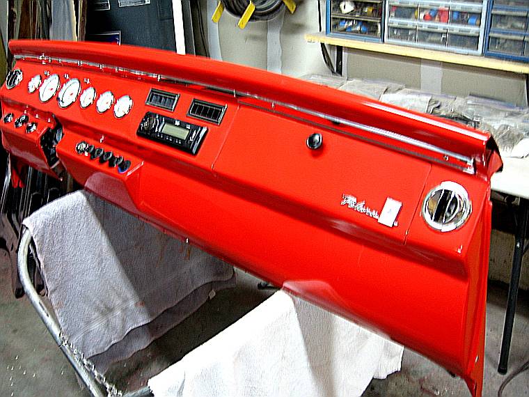

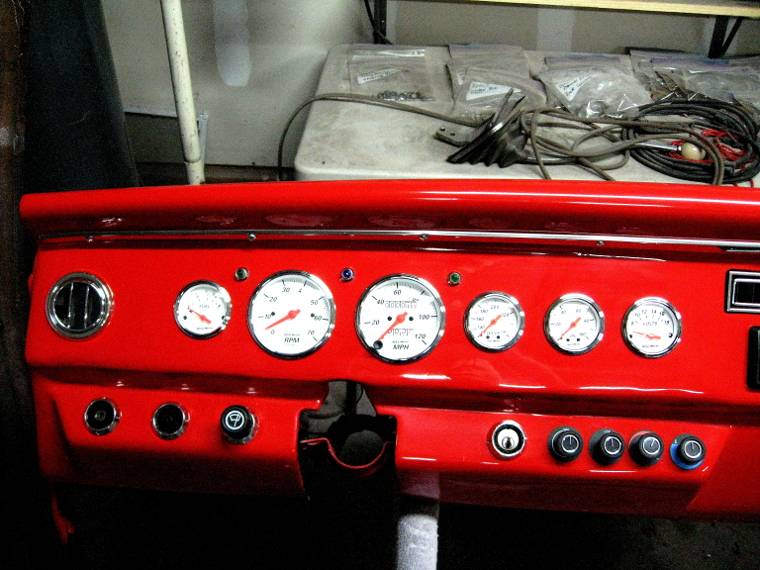

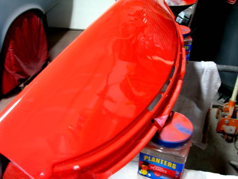

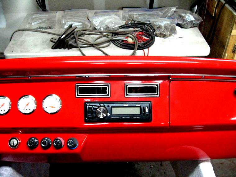

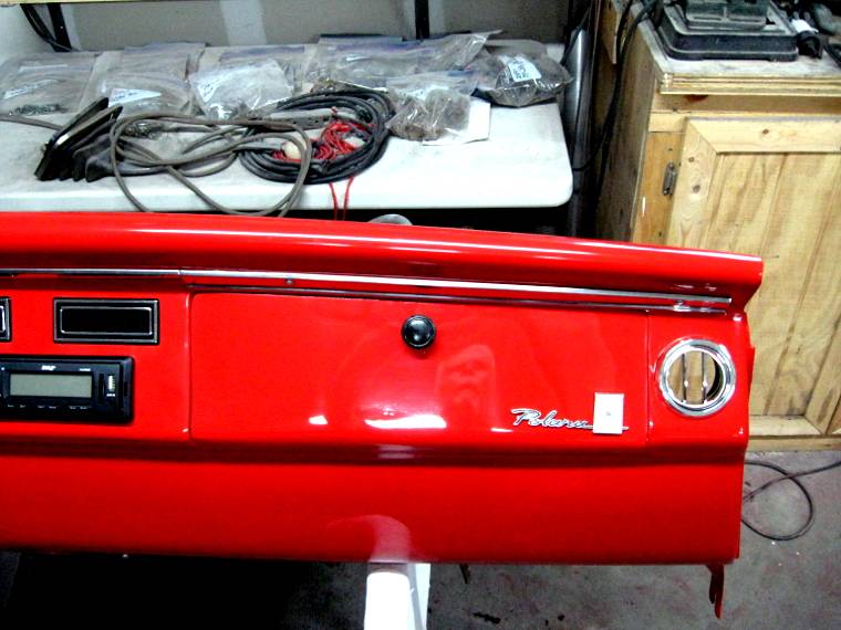

Dash is finished. Searched everywhere for just the right color for the interior and without spending over a hundred bucks on a custom mixed 2K urethane (paint, reducer, hardener) I decided on something unconventional. The perfect color (for me) turns out to be Chrysler Red engine paint.
Picked up a couple cans of Duplicolor engine enamel and went to town. After giving it the weekend to harden I color sanded with 1000, then 1500, then 2000 and then polished with compound and a buffer. Results sure don't look like rattle can and I'm very pleased. Next job is wiring the instruments and lighting. Also need to pick up a new headlight knob.

Wow!! Holy smokes man, that is incredible! Very nice job. I like it! Congrats....:thumbsup::D
That's what I'am talking about,,,,when you do it right,,,,,,WHO SAID IT HAS TO BE STOCK,,great job centerline.Also,,,that is the best paint job I've scene,,FROM A CAN.

Nice job on that. You did what I'm thinking about on my 65 for the outlets. Your dash looks pretty outstanding too Mike. Those DD units are neat.
I have my dash in another thread but what the hell, great minds tend to think alike!

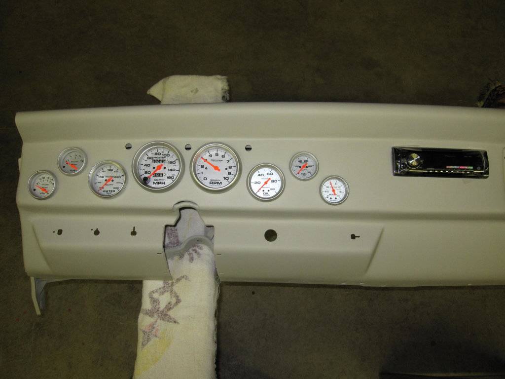

Just looking for opinions.
I know most Mopar people are "original" oriented. Nothing wrong with this at all, however sometimes being a little different can be a good thing. Not talking about doing the Chevy black under the hood or anything like that, but something a little creative like a race inspired dash.
Rebuilding a stock dash, instruments, plastic and chrome can be a bit "expensive". After pricing this stuff on my '64 Polara it was going to run me a little over a grand. So I started looking at options. A race inspired dash, basically flat with a good set of aftermarket instruments, a radio and integrated AC vents sounds pretty good and definitely fits into my budget since that's all something I can do myself.
So my question is: What does everyone think of going with something different than a "stock" dash in one of these cars?

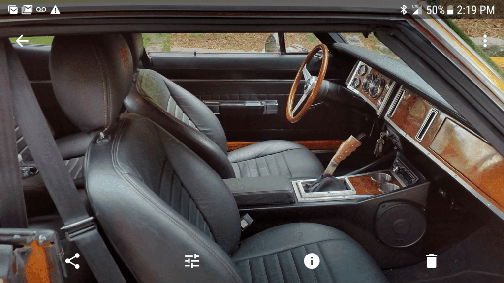

Put an aftermarket instrument cluster in my 72 wired it all for LED and GPS speedo. I'm happy and get kudos at the car shows plus it cost me 1/2 as much as a refurbish OEM. -Just don't throw your OEM stuff away

Centerline ... Now that I've seen your dash I know what needs to be done with mine. Incredible ... Fantastic work. I really like the AC vents on both ends.
How are you doing your defrosters?
I've used Duplicolor quite a bit, on lots of things. It's probably the best rattle can paint out there. I even overlapped single stage paint on it and there wasn't a reaction! I've never tried to wet sand and buff it though, not having any hardener in it. Now I know it can be done.

I would be very careful buffing most Duplicolor rattle can paint. Their engine paint on the other hand has ceramic in it which can stand higher heat so there's less chance of burning the paint when buffing.
I plan on using the stock defroster vents and they'll be connected (via 2" hose) to the Vintage Air unit. I haven't fitted everything together yet and the stock vents are pretty large, so if they don't fit well or the Vintage Air unit is in the way I have smaller vents that came with the Vintage Air system that I can use.
