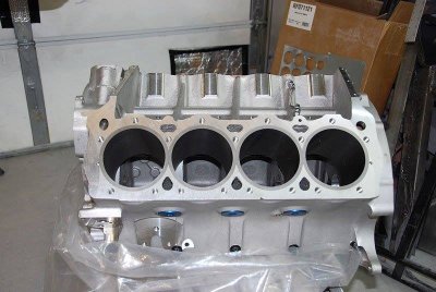

Hey Benno, Yes this is the world aluminum Hemi block.I think turbos would be awesome on a gen ll. If you go with the Aluminum block couple of things to think about.

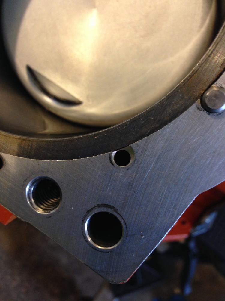

I found out that hydraulic roller lifters don't work well with the aluminum blocks do to how much aluminum stretches with heat.All of your lifter adjustments need to be done when engine is at operating temp.
Also on my world block this coolant hole on all four corners needed to be plugged as you can see it will leak into the lifter valley by going around the sleeves.( I know this from experience)LOL
Other than that great block.
There are a few companies that make them.Just showing the simple fixes that I wasn't told about, in case you get a world block.

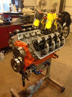

Also,When I took the 440 out I used everything I could out of it to save money.
The stroker kit I had in the 440 I put in the Hemi.I had the Hemi block bored to 4.36 and Bought custom Diamond piston and rebalanced the crank.
I am sure you are wanting to start over.Just in case that can be done.
