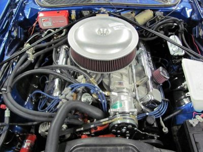

I just put one together for a friend this spring.
440, .030" over, stock rods, forged crank
Diamond pistons, 10.5 to 1 with .010" deck and .039" gaskets
Aluminum 440 Source heads, (which I would recommend Edelbrock now having dealt with them)
Comp retainers, locks and springs
Comp x-treme energy .488"/.491" lift, 230/236 duration @ .050" lift
Hughes 1.6 Ratio roller rockers making .520"/.524 lift
Hedman ceramic headers, 3" collector with 3" full exhaust with X-pipe
Edelbrock RPM intake/ Edelbrock 800 AVS
3.55 gears work really well with this combo.
My only gripe is the cam/valve-train noise, evidently due to the nature of the fast ramp cams. It does have a really broad power range, but I prefer the old school lope with less low end torque, over the valve-train noise.
The noise is also increased with the 1.6 ratio rockers, but I wouldn't want stamped rockers for the sake of adjustability for lifter preload, or even a solid cam in the future, which I believe would make less noise than the present cam.
The biggest misfit that I notice is your 2" exhaust, and I don't recall ever seeing a big block Mopar header that didn't have at least a 3" collector.
