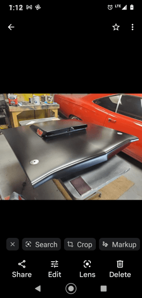

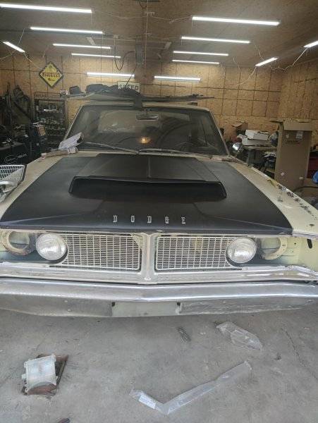

I was wondering if someone could help out. I ordered some paint from 8774paint1.com
I ordered 1/2 gallon of the Organisol SEM 61993 and painted the hood and scoop on my 1966 Coronet.
I mixed the paint exactly like I was told and the paint laid down and covered quite well but the texture is a little rough.
It feels like 1000-grit sandpaper. It was supposed to be a single-stage paint no clear needed but I don't like the texture.
Is this paint supposed to be a little rough or is it supposed to be smooth? It's almost like it dry sprayed. I have painted several cars , motorcycles, and boats and never had a problem like this before. The entire hood is uniform in texture. What recommendations do you have and is there a way to salvage this paint?
Any suggestions is greatly appreciated.
Thanks, JKent

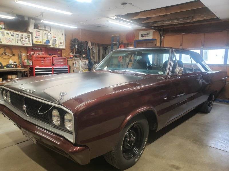

When my guy repainted my original a12 hood I don't believe - in fact I'm pretty positive he didn't use organisol - I wanted to reproduce original look - but decided I didn't like it that rough and flat. I forget what we settled on but it has a slight gloss and is pretty smooth. Just my personal taste but I really love the way it turned out vs the Organisol look. If you like I can find out what exactly we ended up using. You may or may not like the gloss and smooth texture vs rough and completely flat.
Any car show I have gone to each car with black will have something different on it rather than pay for Organisol. The difference makes a Mopar.
