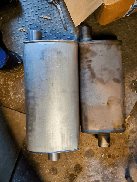

Hemi muffler next to a Magnaflow 3 chamber stainless.
Got sick of the magnaflows (but they sounded great if you were outside the car)

That magnaflo inlet looks pretty small. I'm kinda surprised stock for a 383HP would be 2". It's gotta breathe but twice pipes help a lot. Imagine the assembly line with all the different engines coming down the line. Today it's more automated but maybe back then they had someone supplying the the parts for multiple orders of the same cars and then switching out as the orders changed. Yikes! Worker...damn..what pipes go on this one.
