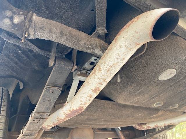

Attaching a picture I snapped yesterday. It's pretty tight back there. 4 inch wide resonators might work but the length would be an issue too. As for general room in this B body, when I purchased the car it was in need of new spark plugs and I can honestly say these are the worst I personally have ever had to change. Had to get all but one from under the car. The exhaust manifolds are really tight against the firewall and then you have the power accessories in the way on the driver side (this car has A/C, P/S,P/B) and the alternator, windshield wash reservoir, trans dipstick on the passenger side and very little firewall room with the log manifolds on either side. With the spare tire in the trunk well and the gas tank it's pretty tight. Could I make it work? Maybe. But a muffler exchange might be the easier way.
What size is the pipe in front of the mufflers? You might try a pair of glass packs in front of the mufflers, as resonators.
But I think I would agree, a different muffler might be a better solution, and probably about the same money as adding resonators.
Me? I might see if I could find some cheap scraps at a muffler shop and fashion some heimholtz resonators as an experiment.
