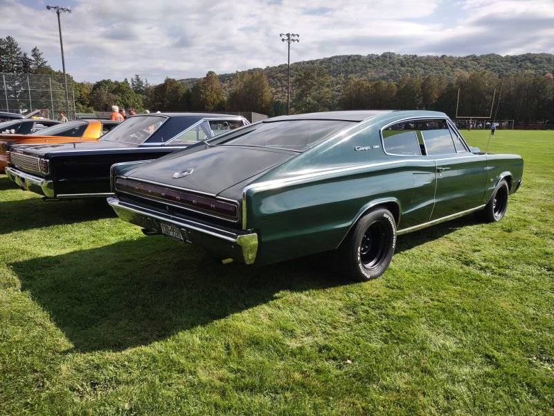

Yesterday when filling the tank at a station an older couple next to me was looking at the Charger and mentioned it brought back good memories from when they saw these in 60's/70's. When I fired it up I heard her say "Now that's what a car is supposed to sound like". Would not like to lose that tone/rumble but the drone...the drone can go.
