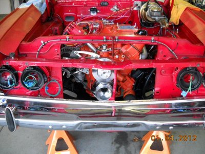

There are two. The one on the passenger side is a flap. The one in the center is a plug...
The one on the passenger side is a flap to close off hot engine air, but also that allows rain water falling into the louvers at the windshield base to flow out of the heating and venting system in the cowl. That is the one that gets full of leaf crud.
