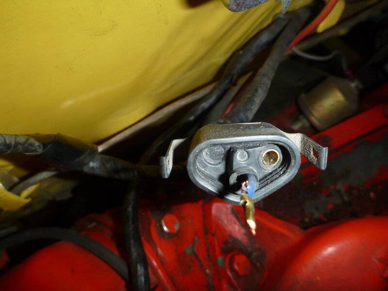

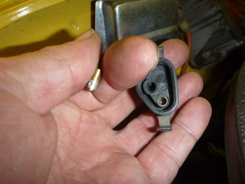

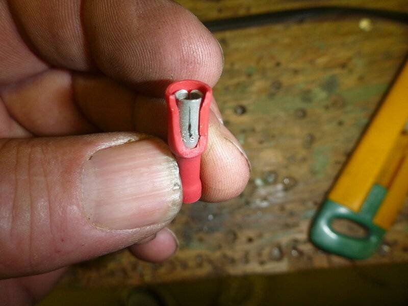

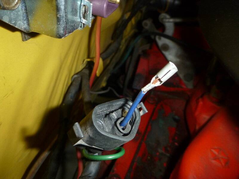

I followed this thread because I had 17 volts coming out of the Alt. also. I pretty much checked all the wiring and found the blue wire on the field had come out of the connector. Soldered to the connector and putting out the right voltage now. Of course I tried VR and alt. and no help. That's the bad part about crimping wires into connectors. I'll try and solder wires into connectors from now on.

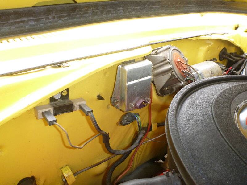

Odmark your voltage regulator points are probably stuck together on a '64.. give the black box a hit! As for the '70 dual field alternator... I covered that, same as tonyst is here, last week. 18volts at 3500rpm and charging 40 amps. Lights on, limp home, fix and go cruise.
