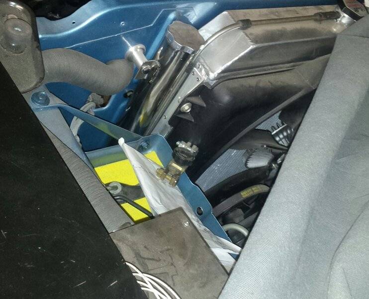

I used one of these from ebay. It fit real nice between the radiator and battery box on my 69 charger.
