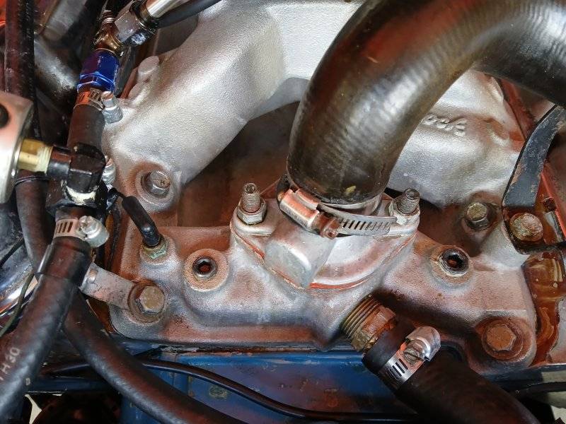

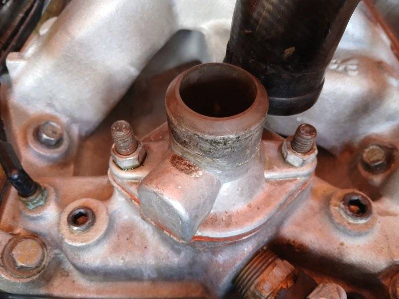

Did we ever see a photo of it? Photos of the hose on and off. Let's see what the t-stat housing looks like with the hose off. Who knows what's going on here.
I'll post a photo shortly.
Here are a couple photos
Paint on the neck of housing will cause the hose to slip off.

I never painted that. That's how I got it. I could sand it down a little, but I think I want one with a lip.
Yes. Very odd. I've got a chrome one that has a lip, but I could never get it to seal right at the manifold
Those chrome ones are junk too.
They sure are. I just put the chrome one I have on my work bench and it wobbles. Ugh. The one I just took off -- the one with no lip -- is perfectly flat. I'm getting a new one with a lip
Test and/or replace the radiator cap, and for sure get a thermostat cover with a lip so the hose won't just slide off.

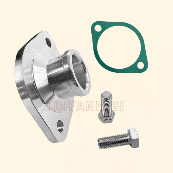

I only suggested these to the
OP as the gooseneck on his
engine has no hose barb.
These shrinkwrap clamps
are designed for just that
purpose.
6 bucks for a clamp, or
20 bucks for a gooseneck?
