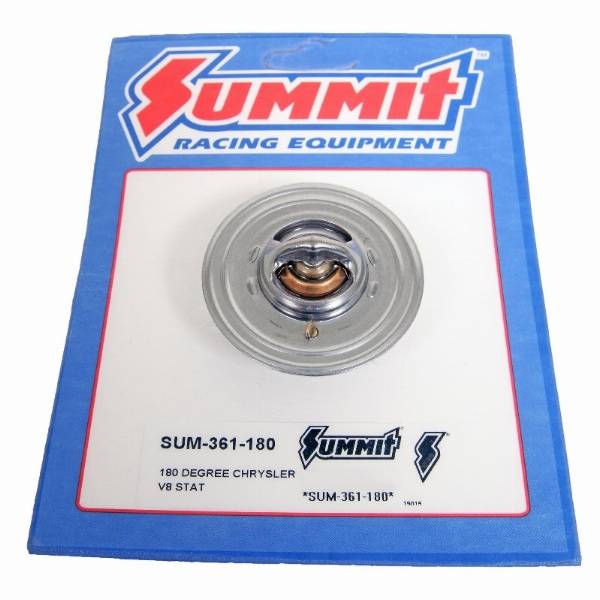

It's likely flow, if you're overheating at speed. Higher rpm= more heat output. All the aftermarket thermostats, like the ones pictured, are smaller opening=less flow than what Mopar intended in the 60's and 70's. If you find on original thermostat like 2128994 or similar later versions, the opening is nearly 33% bigger.

I did still wonder about the hole in the thermostat. I've seen some with a small spring loaded sliding valve/pin.

You can drill a 1/8" hole, or have a little "wiggle piece of brass" in an existing hole or similar. It's just something to allow any potential trapped air to not get stuck behind the thermostat....hot air bubbles won't let the thermostat open....so you get the bubbles out.

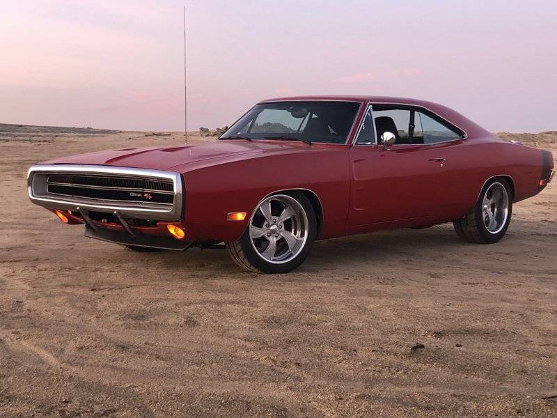

Jigsaw does not have Air Conditioning.
The red car does.

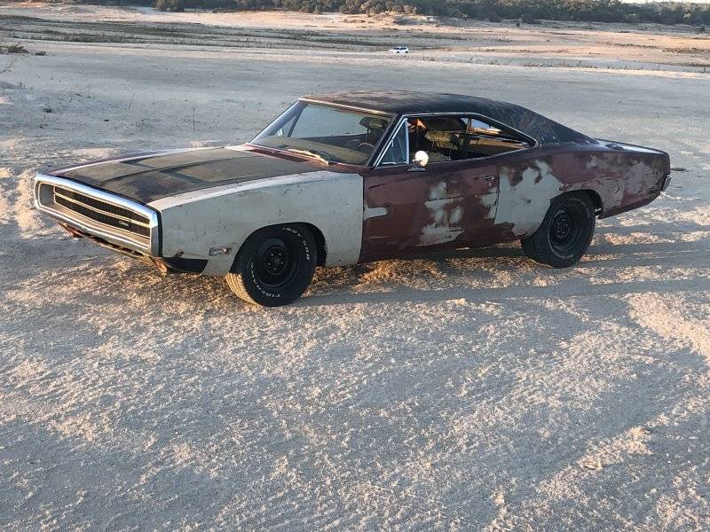

it appears Jigsaw is also lacking a fan shroud
I ran without one in the red car for years without overheating. It wasn't even a hot day yesterday, maybe 85.
I know it isn't ideal but this problem came on suddenly. An hour after shutdown, the hood and top of the bumper were still really hot.
This car:
.....is a hodge podge of used parts, hence my nickname for the car, Jigsaw.
