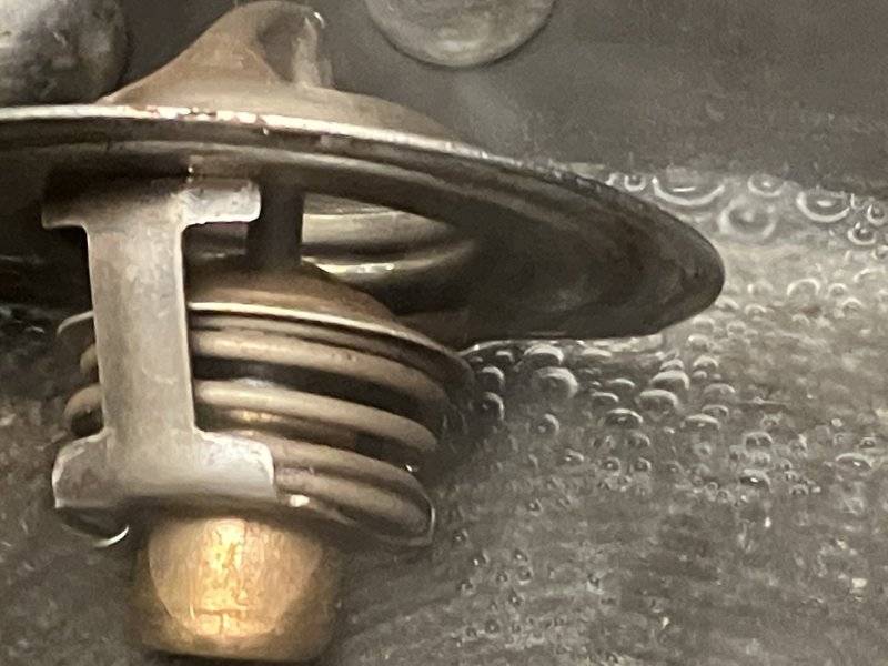

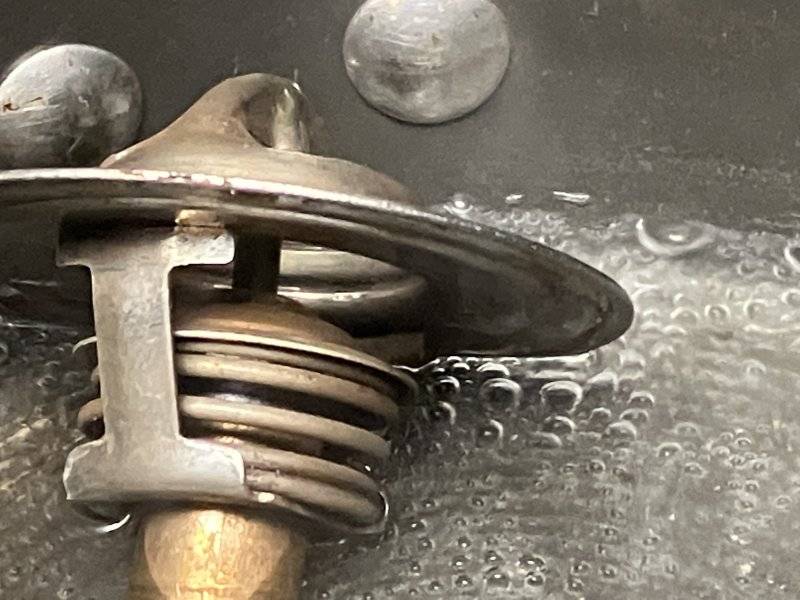

At home, I put the thermostat in a pan with water and set it to boil.
It is a 180. It sure looks open to me.

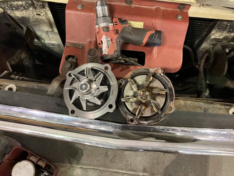

I’ll have to change to a 1970 correct water pump housing with the LH lower hose nipple. No problem, I have a few to use.
Which water pump would you use?
It seems to me that the one on the right (GMB) would move water better.
