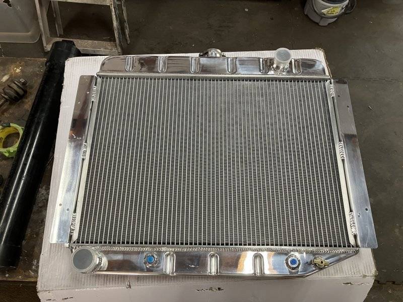

The radiator arrived last week.
Pretty nice looking unit for a beat up car!
Transmission cooler at no extra charge….
Nice thick mounting flanges:

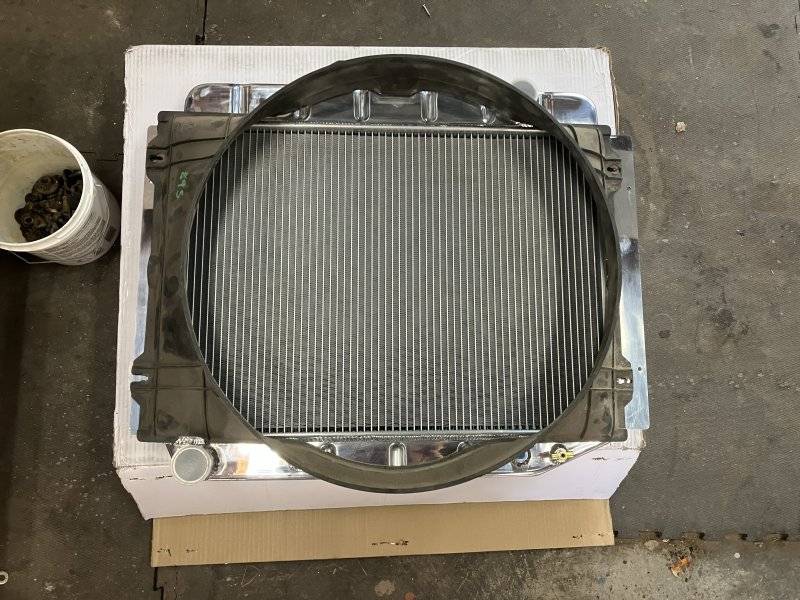

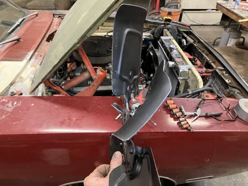

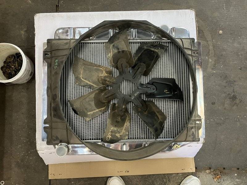

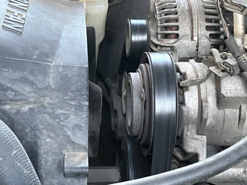

I went through my stash and picked a shroud. I have 2 from the 85-89 Chrysler Fifth Avenue cars. They had 26" radiators but also used bigger fans. The opening in the shrouds that I have are approximately 22", compared to around 20" in the stock shroud I have in the red car. I'll be using a bigger fan and shroud with this radiator. I've used a 19" 5 blade fan but I'm switching to a 20" 7 blade fan from that Fifth Avenue.
Since the shroud isn’t stock, I had to clearance it a bit where the hoses will go.
