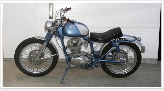

I actually have two. One is an early in the model year 1963 250 Scrambler. They are pretty rare and worth some good coin restored. I bought it as a really rough rolling basket and want to try to restore it to stock. Here's what one looks like restored:
The other is a 1964 250 Monza that someone put a big-valve, big port head with big cam on sometime in it's past. This one is really rough too. I want to make that one into a Cafe bike.
