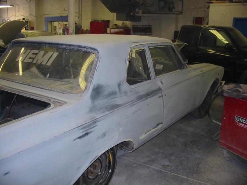

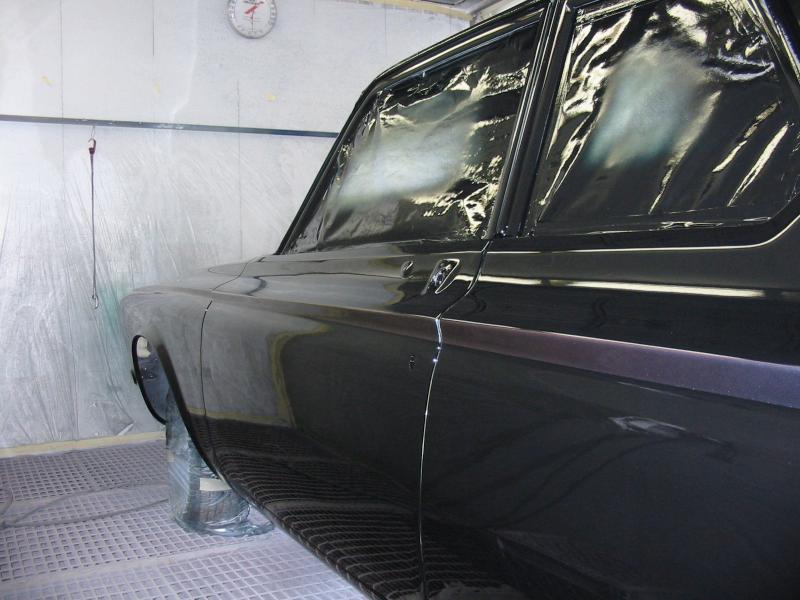

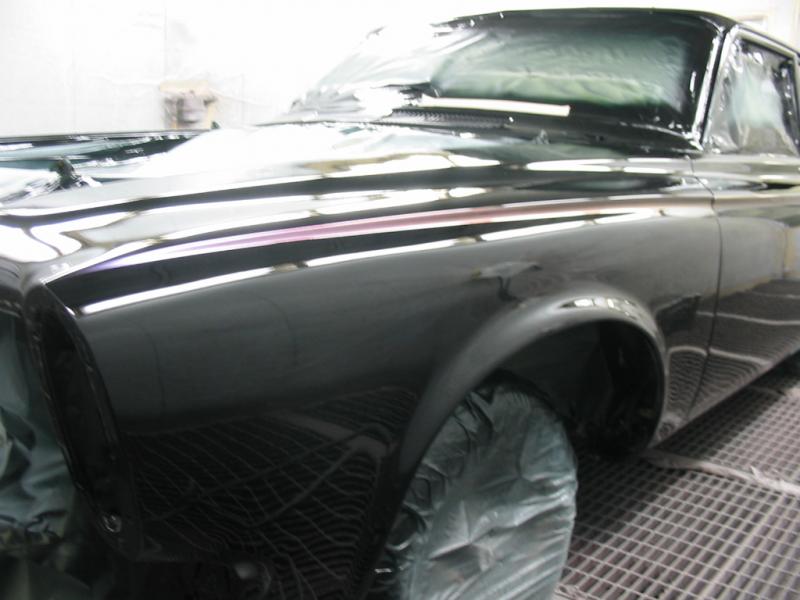

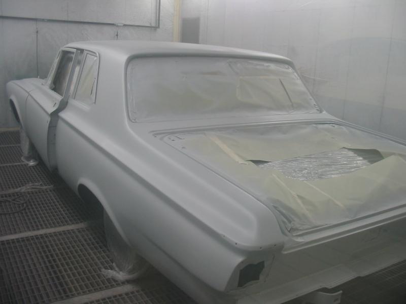

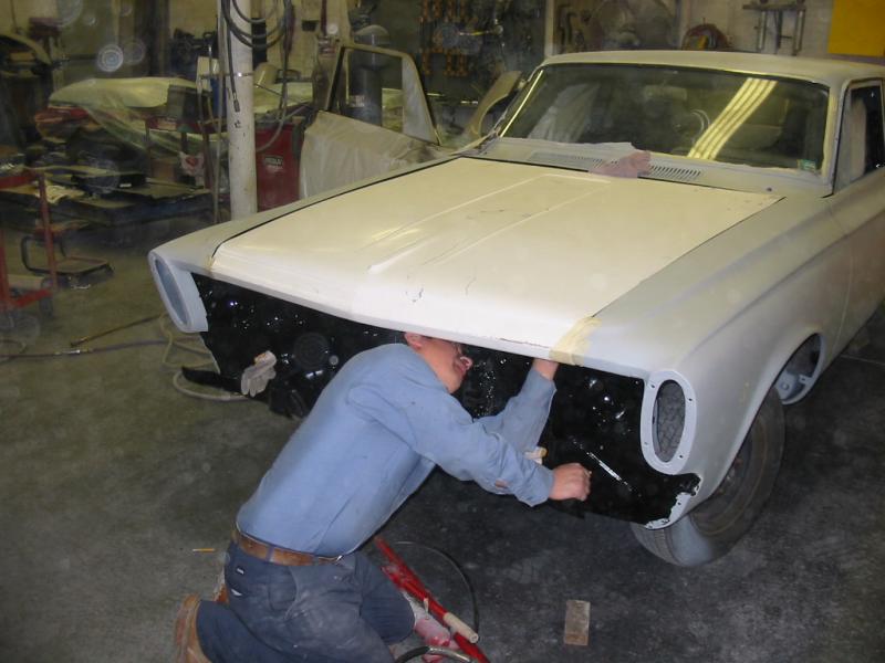

When I had mine sprayed,I had a set of regulat steel wheels with some tires that held air.Most body shops have covers,but I took no chances:blob1:
